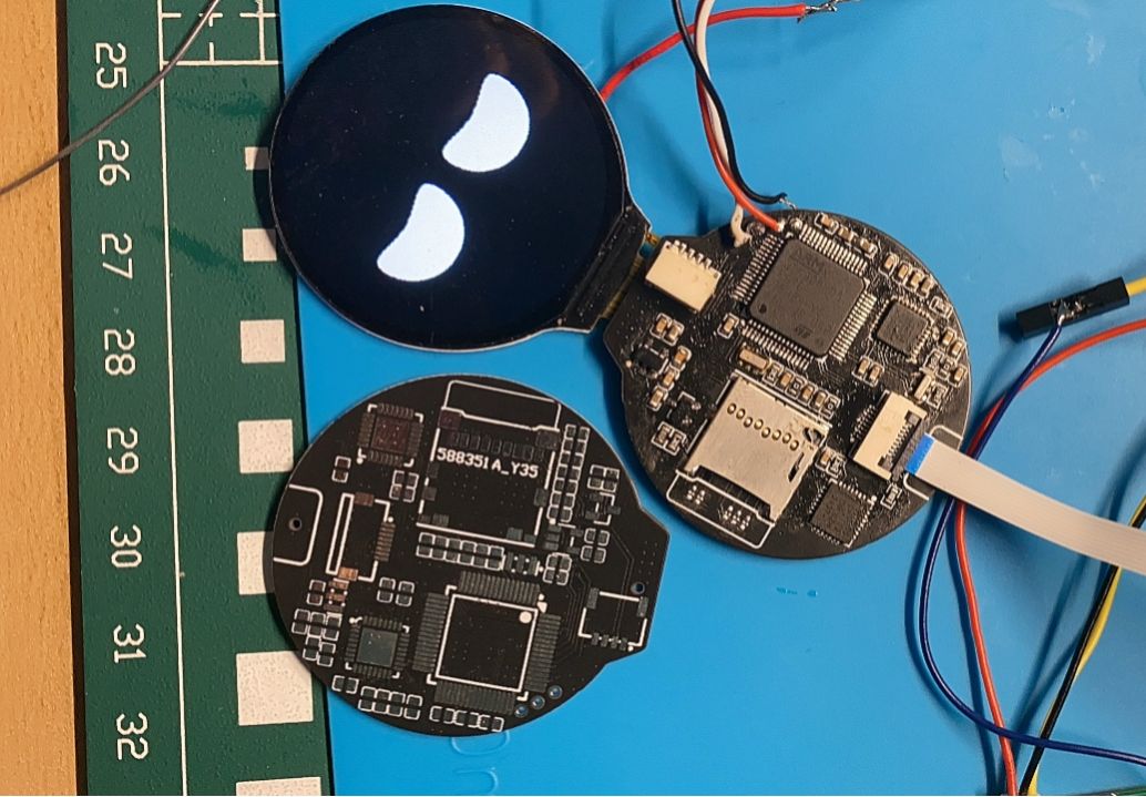

Based on the head PCB board of electronic robot, an open source project of Zhihui Jun, its open source connection is peng-zhihui/ElectronBot (github.com). The package resistance and capacitance packages are all changed to 0603 to facilitate welding. Some wirings are optimized to replace the same small size. TF card holder (available and cheap at Lichuang). . .
