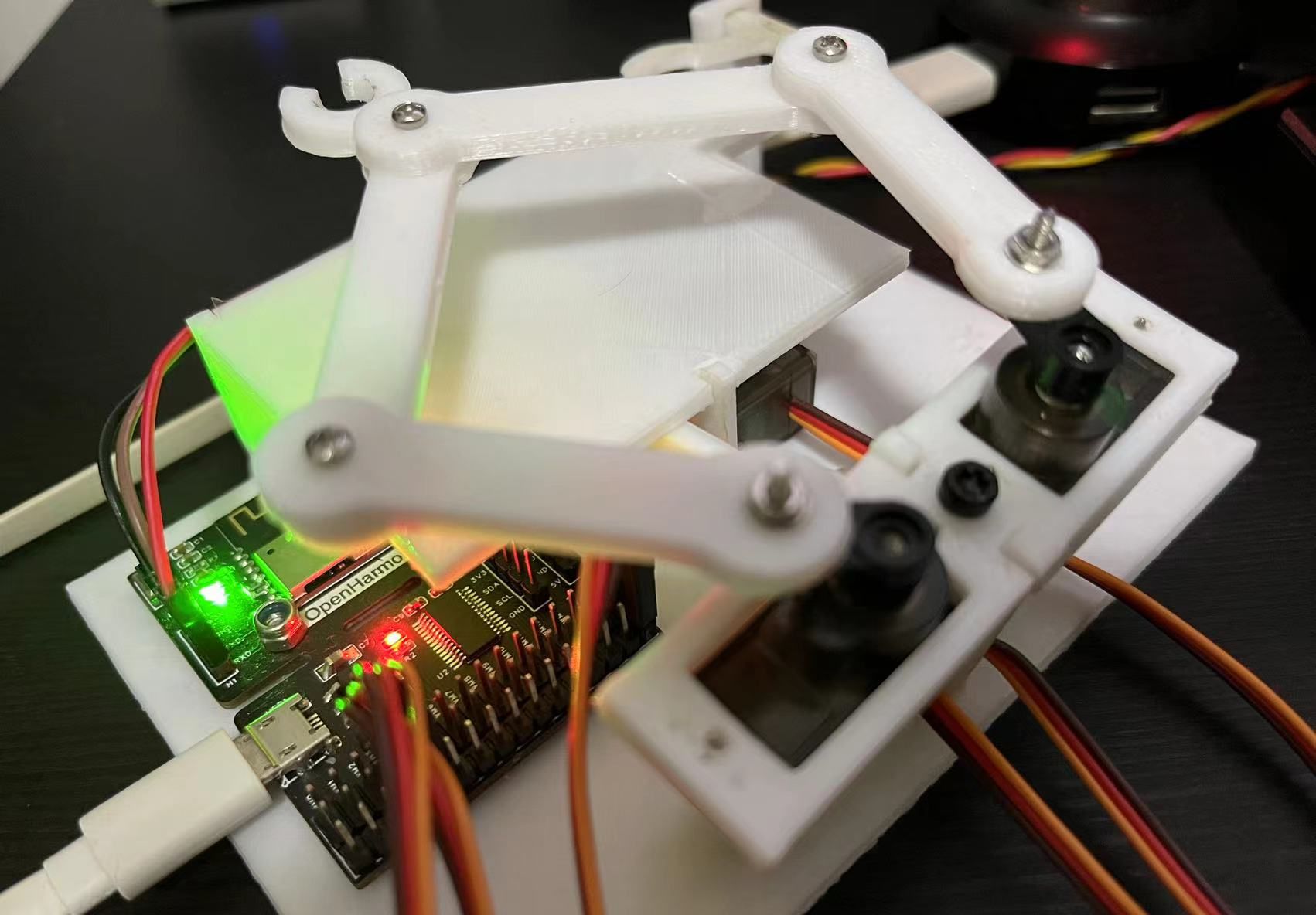

2022 Lichuang EDA Bionic Robot Dog Training Camp Project Hardware (drawn using Lichuang EDA Professional Edition) Main Controller: Huawei Hongmeng Hi3861 Servo Driver Chip: PCA9685, using IIC interface communication, can drive all IOs and IIC of 16-channel servos at the same time The expansion interface, expansion power interface, etc. have all been introduced. Later, it can be used as an evaluation board and built for Linux using the software development environment. Reference: https://robot.czxy.com/ohos/day04/harmony_linux_env.html Based on genkipi, the structural parts are developed. 3D printing, please see the attachment for the part printing file reference: https://www.thingiverse.com/thing:248009 3D structure coloring diagram:image.png
