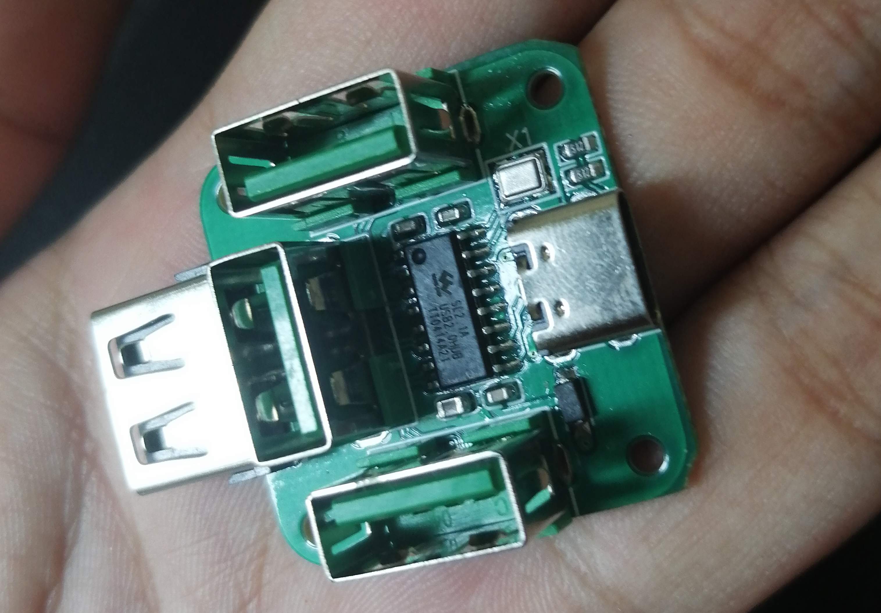

Verified USB HUB is based on SL2.1A one to four
# Based on the SL2.1A USB2.0 HUB
diode, you do not need to directly remove it, and then short-circuit or modify the PCB so that the power is directly input to the chip. SL2.1 has built-in LDO, and the surrounding capacitors are mainly used to filter the power supply and built-in LDO.
参考设计图片
