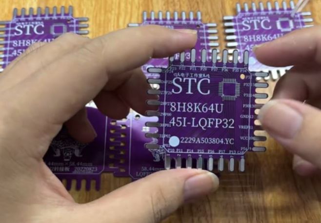

HQFP32-STC8H8K adapter board
Physical display: HQFP32 microcontroller-STC8H8K_bilibili_bilibili
This PCB is customized for the STC8H8K-LQFP32 package. The PCB design refers to the size of LQFP32. The magnification is 6.25 times, so the pin spacing is 5.08, which is exactly 2.54 pin spacing. It's multipled.
The PCB is not painted purple, nor is it black like the chip, which can highlight the chip on the board.
There is a via hole in the upper right corner of the PCB for threading cables. M2.5 hole. It won't look good if you drill too many holes, just leave one.
This is an adapter board for LQFP32. There are two capacitors on the back, one is UACP and the other is powered by VCC.
The pin header can be soldered on or used as an adapter board.
