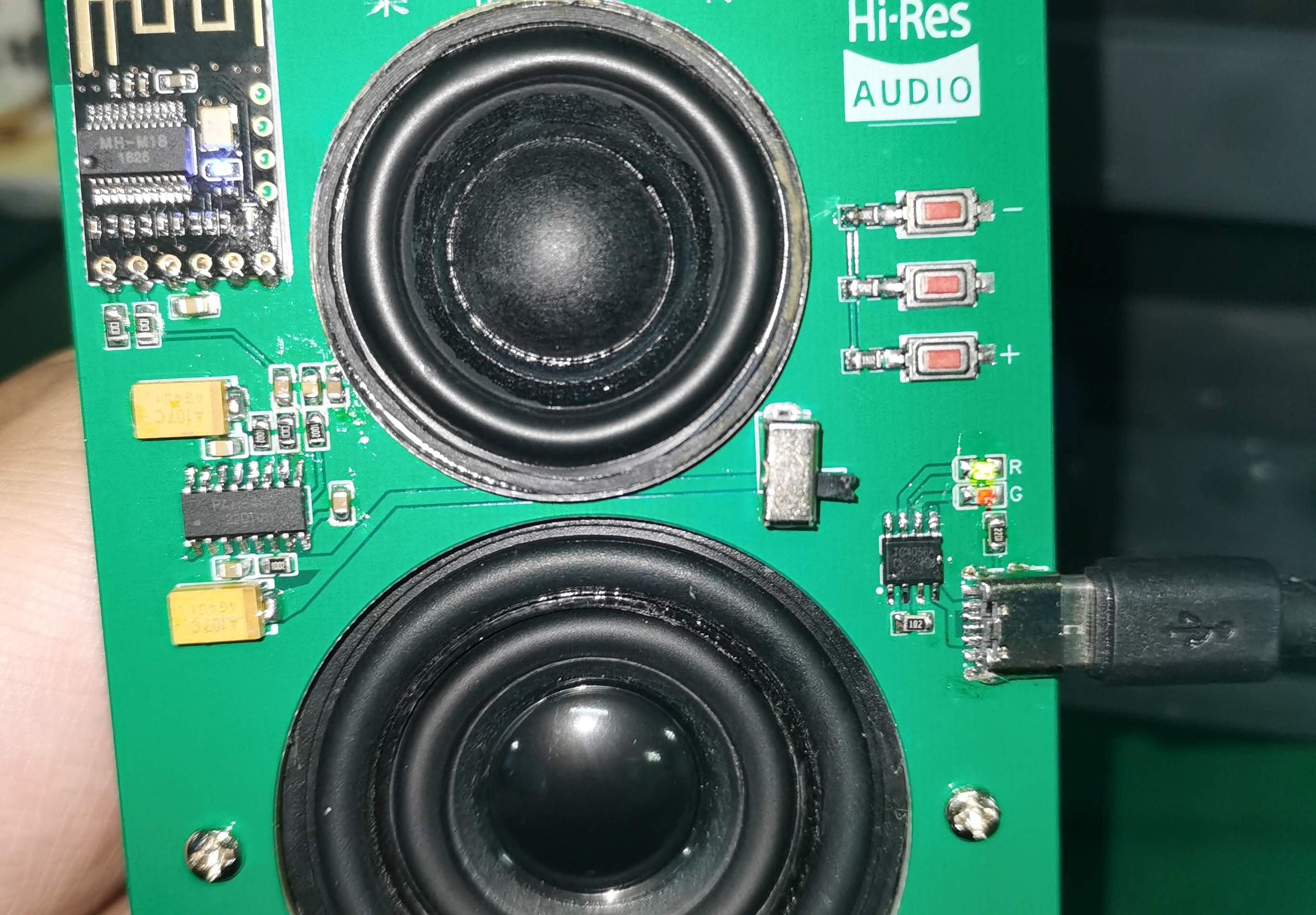

Desktop bluetooth small speaker
A small desktop speaker using M18 Bluetooth module and pam8403 Class D amplifier. The circuit is simple and the sound quality is good. Pay attention to some details. A large-capacity capacitor is connected in parallel to the power supply. The bass is better. Two 10u treble speakers are connected in parallel.
