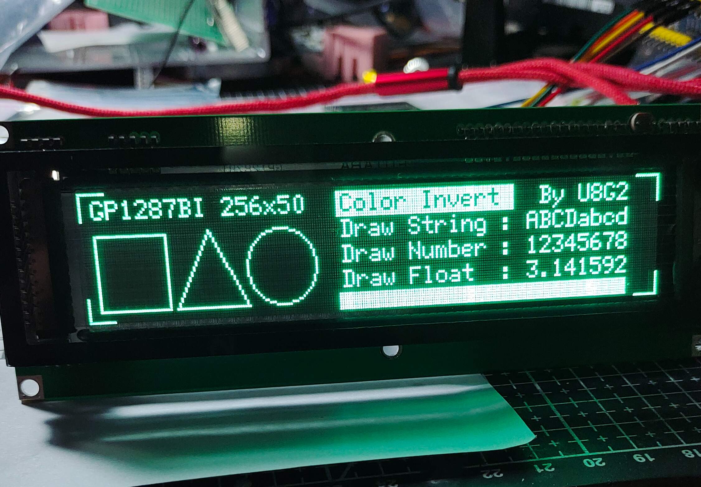

## Display the rendering
![image.png]
![image.png]
