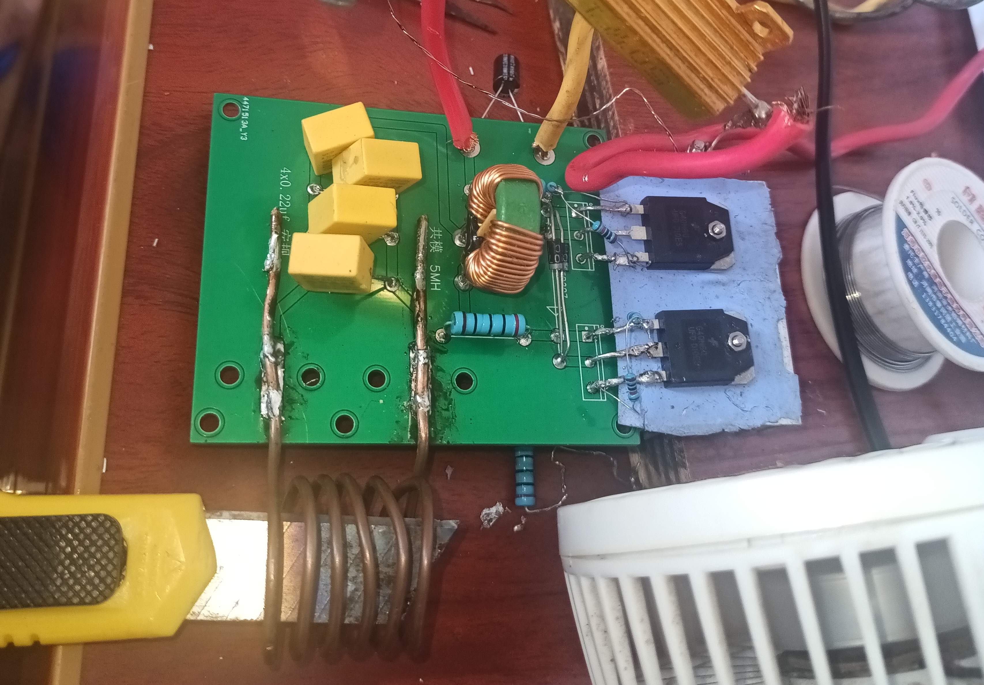

50w electromagnetic induction heating
Use a 2A-4A 12V power supply. It is recommended to use an adjustable power supply.
Ordinary power supplies will report overload and require a current limiting resistor.
As shown in the figure, the current limiting resistor
used here is
The limited resistance is as shown in the figure
a list of 1 ohm 50W aluminum resistor components;
G40N60*2
200-ohm*2
fr207*2
common mode inductor 5HM*1
0.22UF safety capacitor*4
10K*2
25V100UF*1
copper coil : 6 turns inner diameter 24mm, height 25mm
