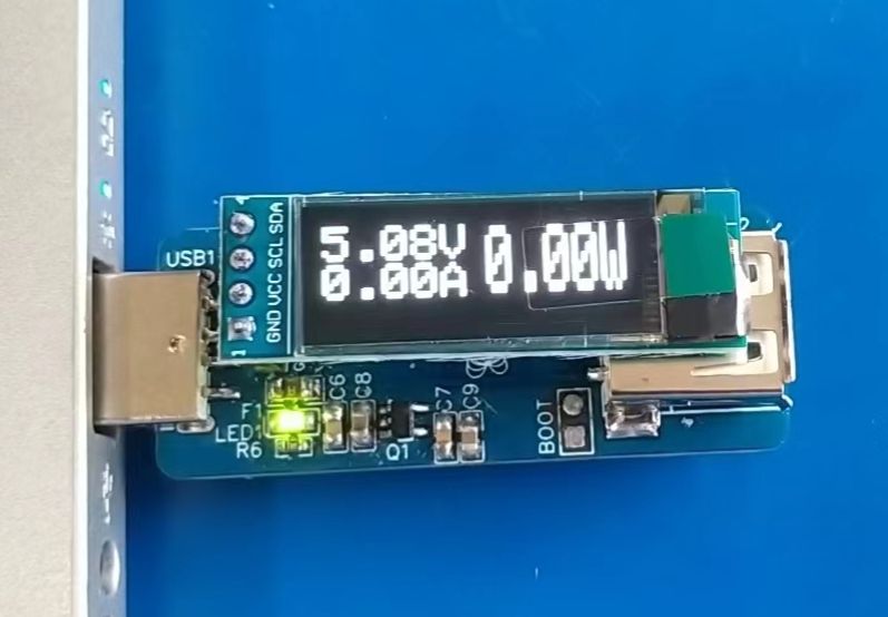

* 1. Project Function Introduction
Follow the training camp to design a USB voltage and current meter

converts the current into a voltage value through a sampling resistor and a current sensing amplifier chip, collects the actual voltage value through a resistor divider, and transmits it to the corresponding IO port respectively, and then calculates the real-time power. OLED display is realized through single-chip microcomputer control.

uses the official code. After modifying the actual voltage and the displayed voltage ratio, everything is displayed normally. Use ST-LINK to burn the program
. Note: If your project involves software development, please upload the corresponding engineering source code in the attachment. Here you can explain in detail your software flow chart, functional module block diagram, explanation or popularization of related algorithms, source code structure, compilation environment construction and configuration, source code compilation method, program burning method, etc. It is recommended to introduce your ideas to others in the form of pictures and texts.
