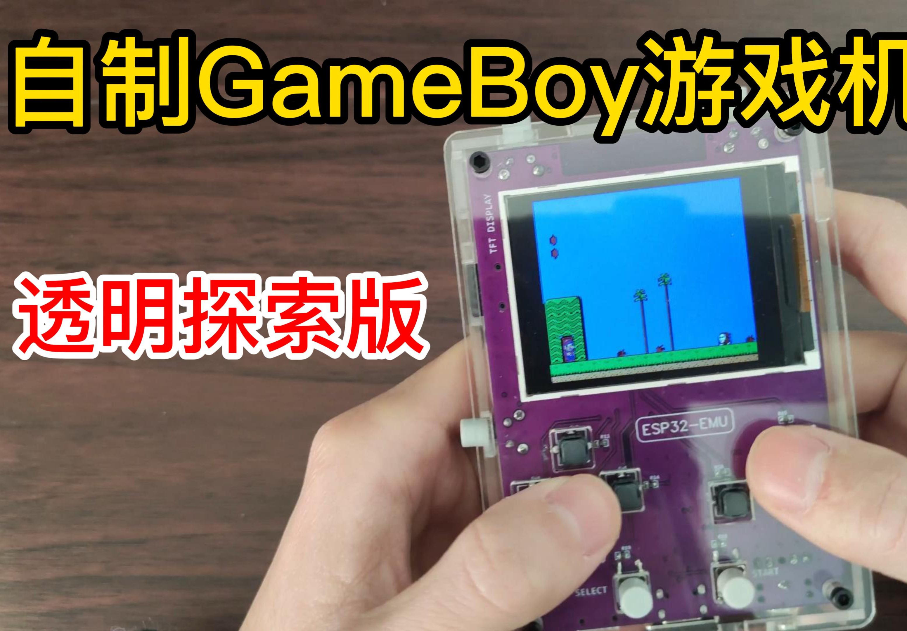

1. This project is based on esplay. Some components and circuits have been modified based on the original author's work, and the pcb has been redrawn.
esplay project address: https://github.com/pebri86/esplay-retro-emulation
2. The production process can be seen here Video https://www.bilibili.com/video/BV1FL41157vK
3. Precautions
① IO0 and IO2 of ESP32 should be short-circuited, which can be done with a piece of tin
② A 3 mm thick spacer should be added between the PCB and the upper acrylic cover. 2 pieces of 2 mm acrylic spacers and then polish off 1 mm. You can also use stainless steel spacers to make up to 3 mm.
③ The 6 buttons up, down, left, right, A, and B need to be added with a 1.6 mm thick PCB pad.
④The screws used are 4 M2.5*5, 4 M2.5*10 and the studs are 4 M2.5*10.
4. The finished product rendering
uses 2 mm acrylic for the shell and is fixed with M2.5 screws
5. Firmware burning address
lU6Nj792SATigeQmQJXnHg9SDQAKYWDODgfgAGim.png6. TF card directory structure
Game archives need to add a data folder in the esplay directory, which contains folders with simulator names such as nes, gbc, etc.
