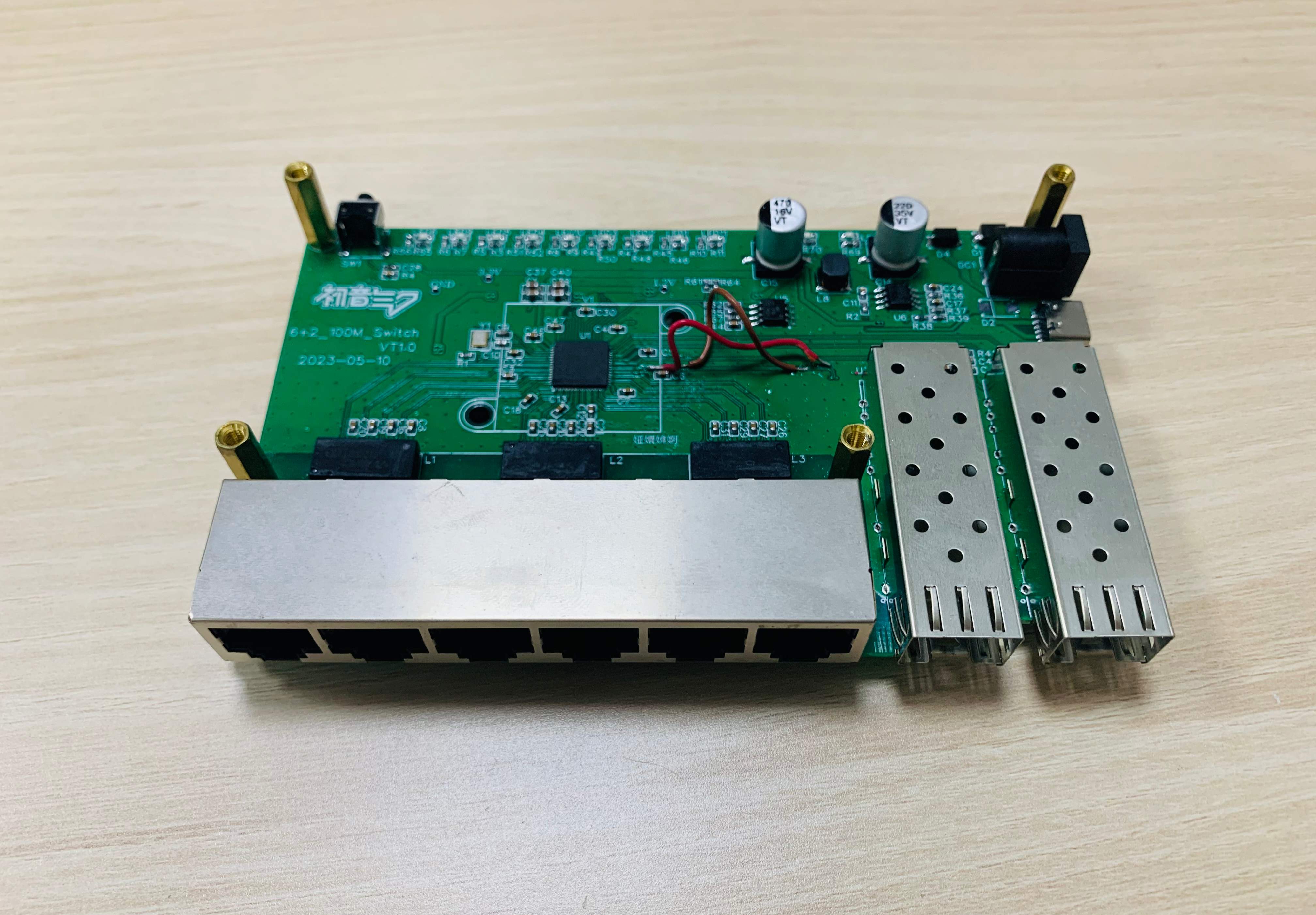

I need a switch with more than two optical ports. At this time, I re-read the RTL8309N datasheet.
The working principle:
power supply circuit, LED light pin configuration, network port differential configuration, VLAN (virtual local area network) are all omitted and not explained. They are not the focus of my discussion. The focus is to configure it as an SFP port.
I re-read the RTL8309N datasheet (as shown below), and I found that this RTL8309N chip can support configuring all ports as SFP ports.
This configuration requires register configuration, which is not written in this datasheet. (Find another method or have internal information)
But I have already written a firmware (attached), which can be used or referenced.
Through CH341A programmer, write to eeprom (24c02 chip and above can be used normally)
The firmware I edited only changes two places:
1. Configure the 6th and 7th ports as SFP ports, and keep the other 0-5 ports as they are.
2. Configure the 6th and 7th ports as Uplink ports, which are also called uplink ports.
At present, the optical port cannot be used, but the electrical port can be used normally. At
(Important things are said three times!!!)
I am very sure that there is no problem with my firmware writing. There should be an unknown problem on the circuit board (there was not much time when I adjusted this optical port, so I gave up due to delays)
After configuring it as an SFP port, polarity correction cannot be used. (I made a mistake on this point, and the subsequent flying line still cannot solve the problem of the SFP port) (The schematic diagram and PCB have been repaired)
Actual photos:
