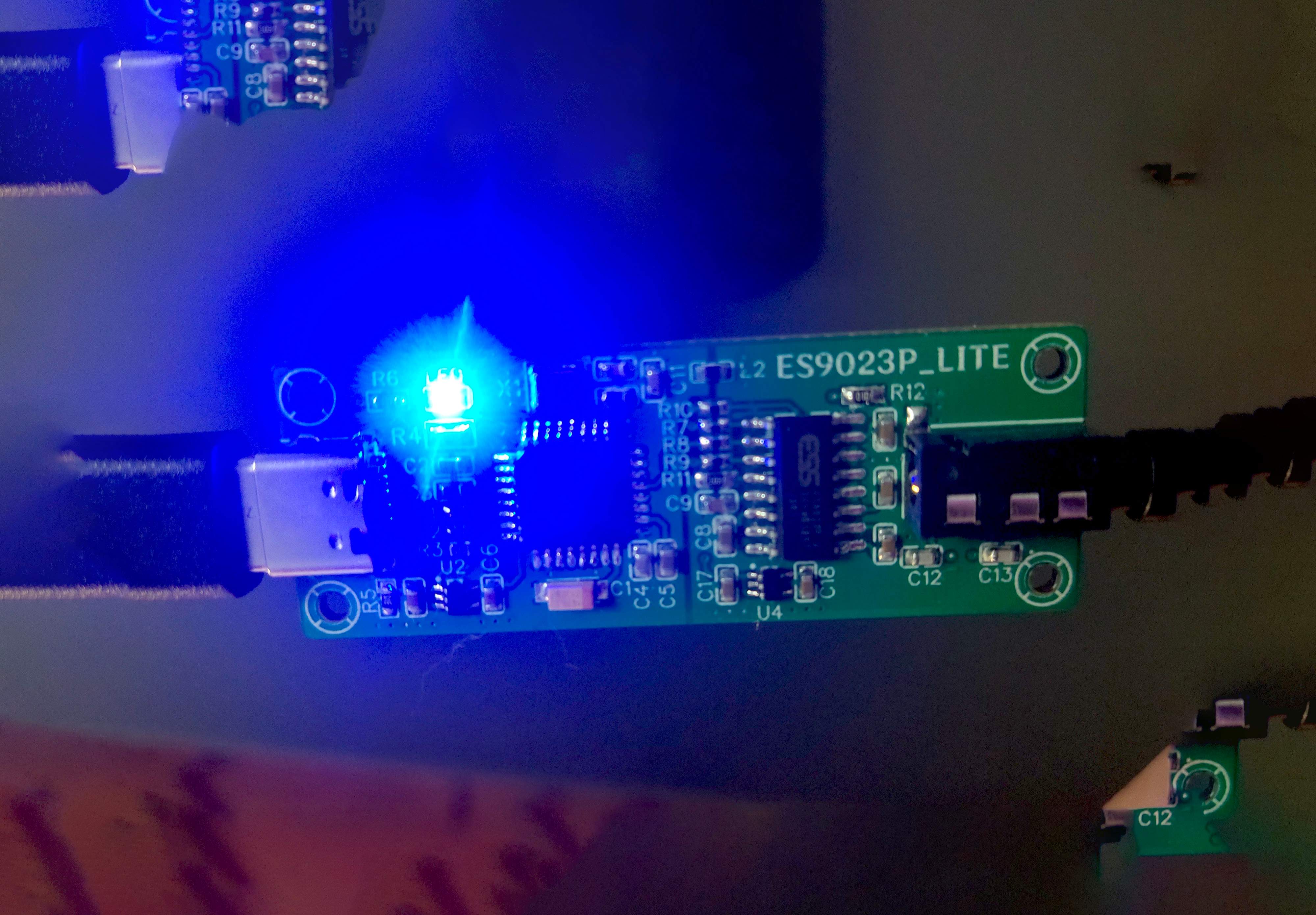

USB mini DAC
V1.1 update: Increased the width of 5V and 3.3V power lines, optimized the layout and wiring of some components, as shown below:
This is a mini sound card made with PCM2706C+ES9023P, which is the one mentioned in the last ES9023P verification board The project
was made a few months ago (the first version, the design defect caused output clipping and distortion)
was turned out a few days ago, the design bugs were fixed, and released for everyone~
The USB interface is PCM2706C, 16bit/48k, listen to it MP3 and lossless CD are still good, no need to drive or firmware;
the decoder chip is ES9023P, 24bit/192k specifications, comes with a headphone driver, I personally think it sounds good, the SOP16 package is also easy to weld; the
power supply of 2706 and 9023 is provided by a ME6211 respectively
Below is a physical picture of the first version. You can see that C8 does not have a parallel resistor, resulting in clipping distortion.
The new version has been redesigned, added a resistor, the DIF pin is directly connected to ground, and the LDO package is replaced by SOT-23, which is easier to buy and has better sound. It should be no problem.
