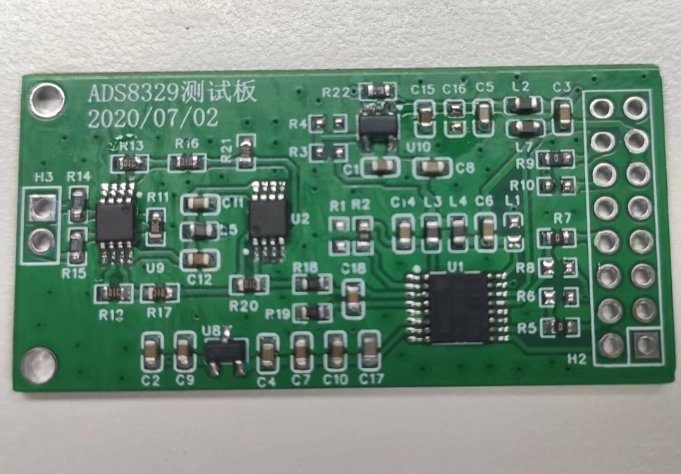

The hardware circuit
design is relatively simple, the instrument is differential, amplified by 2 times, pay attention to the signal range of 0-2.5V, and do not connect to negative voltage. The voltage reference is REF3025, and the LDO voltage regulator chip is the low-noise and high-PSRR LP5907MFX.

measured results
input uses a resistor divider of 1/2 and amplifies it by 2 times, so the measured results are consistent with the oscilloscope.
The following figure shows two ADC chips cascaded, with a sampling rate of 500k and a 50k signal.
The following figure is a test photo of a single chip
