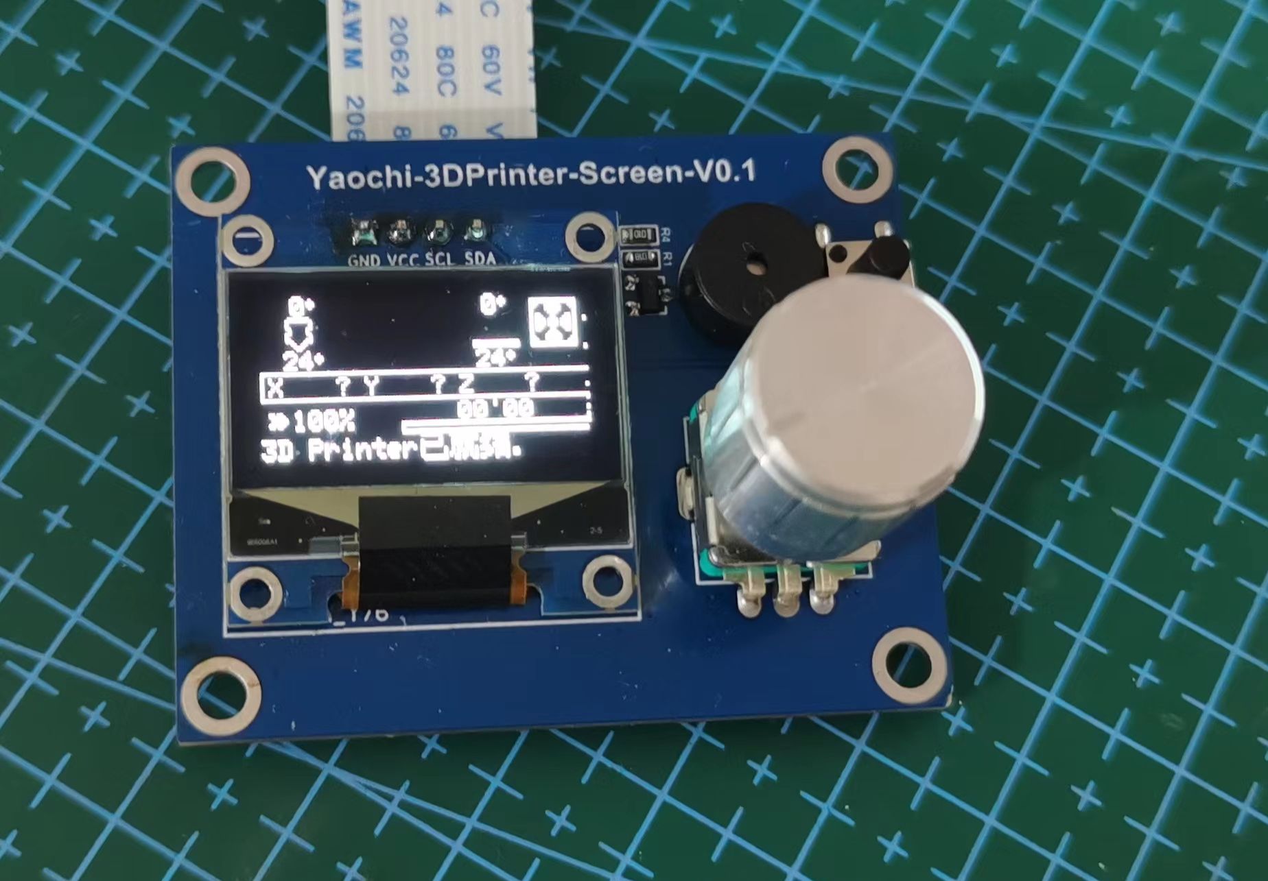

  A control board matching the motherboard of its own seven-axis 3D printer.
  When connecting to the motherboard, pay attention to whether one leg of the FPC cable corresponds to the other.
  The default pin sequence is GND VCC SCL SDA 0.96-inch OLED controlled by ssd1306.
  PCB and BOM are in the attachment.
