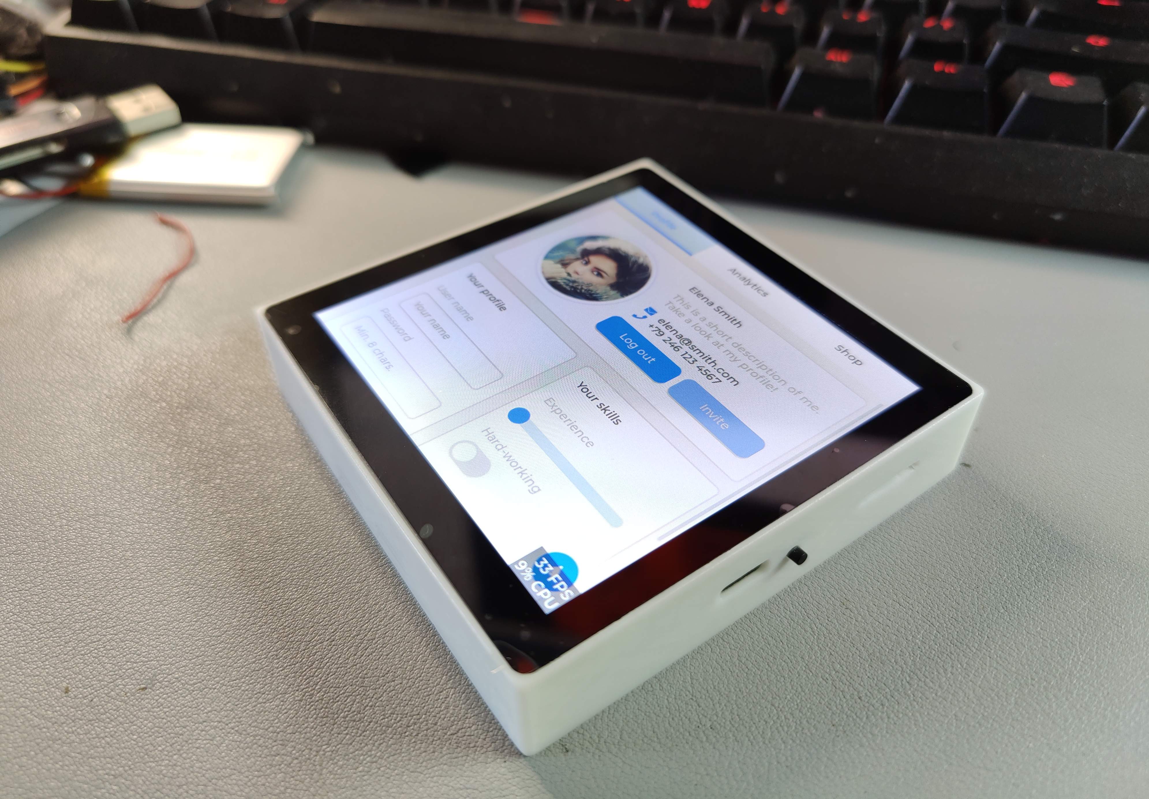

ESP32S3 86 box development board with touch
An 86-panel development board using ESP32S3N8R8 as the main control. It can be used for 86-panel development with touch
. For LVGL development,
please choose a 1.2mm thickness for the board.
Please choose a 1.2mm thickness for the board.

Hardware Configuration:
Screen: ST7701S
Touch: GT911
Charging: TP4056X
DCDC: MP2155
Audio: MAX98357
Serial port: CH340K
Master: ESP32S3 N8R8 (8M Flash 8M Psram)
Screen compatible with Arduino_GFX library
file: (Attachment is provided)
Arduino_GFX screen driver library: https: //github.com/moononournation/Arduino_GFX
touch driver library: https://github.com/TAMCTec/gt911-arduino
LVGL library: https://github.com/lvgl/lvgl
Please note when compiling:
ESP32 development board library version : 2.0.5
Please note when burning:
Please install the battery and turn on the development board before burning.
Note:
Since the 4-inch screen of ST7701S is slightly different from each manufacturer, the driver may not work. Therefore, this project uses Huaxian Technology’s SPI+RGB666 square screen
Huaxian Technology: https://item.taobao.com/item.htm?id=654496994484 When purchasing, I told the boss that I wanted FPC silk screen printing of the BH040-01
header . You can also try other ST7701S square screens. There are 3 different ST7701S modes in the ArduinoGFX driver library. For details, please check the WIKI of the Arduino_GFX library: https://github.com/moononournation/Arduino_GFX/wiki/Display-Class
Screws: https://detail.tmall.com/item.htm?id=598853940789 Specifications: 2*5*4 (100 pieces)
Nuts: https://detail.tmall.com/item.htm?id=20955552239 Specifications : M2.0 (100 pieces) 304
speakers: https://item.taobao.com/item.htm?id=684864879619 Specifications: 2030 cavity-4Ω3W
Antenna Specifications: 2.4GHz IPEX1 generation antenna

align the PCB with the holes, then fix it with screws and nuts,
then tear off the double-sided tape behind the screen, install the screen into the groove of the casing, and insert the cable into the FPC seat
Plug the speaker and battery into the corresponding sockets (be careful not to insert them backwards).
Glue the speaker diagonally to the position of the speaker.
Then use double-sided tape to fix the battery to the back panel of the back cover.
Use epoxy resin glue to glue the nut to the back panel. of the screws, wait for the glue to solidify,
then cover the back cover, secure it with the screws,
and then you can play happily.
