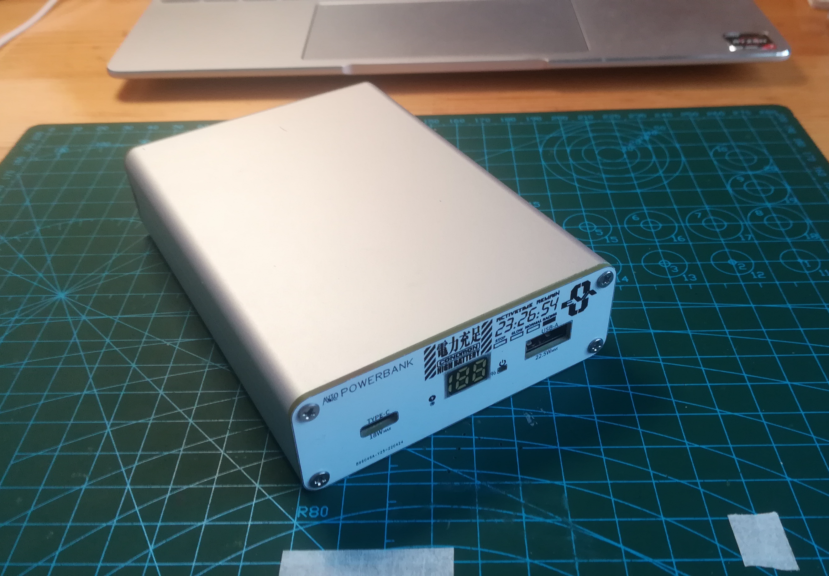

Main functions:
Maximum 22.5W output, 18W input
Interface configuration: 1A (OUTPUT) 1C (IN/OUT)
supports digital tube display of power,
supports up to 25000mah battery, with calibration function
Production:
Material:
Aluminum alloy shell 1 (what I use)
Aluminum alloy shell 2 (cheaper, it should be compatible depending on the parameters)
18650 battery box (the height is a bit large and needs to be polished. You can also use it without it, but you need more foam glue. I bought it because it is convenient to replace the battery) ( If you use 21700 batteries, no need)
Digital tube (the shipping fee is a bit expensive, but I couldn’t find a second one)
A-port female socket (choose 6.3)
Another: NTC thermistor If you buy this in this store, remember to measure it before use It was good and then I put it on the computer. The new one had a short circuit (I didn't test it before putting it on the computer) and I spent an afternoon repairing it. (That’s not to say that other companies have no problem.)
Just find a 16P one for Port C. The one that I bought is
IP5358 and you can see for yourself. I used to buy it for 8 yuan a piece, but now it has gone up. There are two versions of IP5358 on the market. , mainly PD protocols, one supports 12V1.5A, and the other supports 9V2A.
Also:
It is recommended to pay a little more for a black shell, and then paint the front and rear panels black. Defects are not easy to see. The white front and rear panels are easy to get dirty, and all five of my front panels had flaws after being repainted, so I chose a similar one from General.
Finished product picture:
IMG_20220606_092149.jpgIMG_20220606_092222.jpgIMG_20220606_092201.jpgIMG_20220430_100053.jpgIMG_20220430_155920.jpg
VID_20220430_172459.mp4
