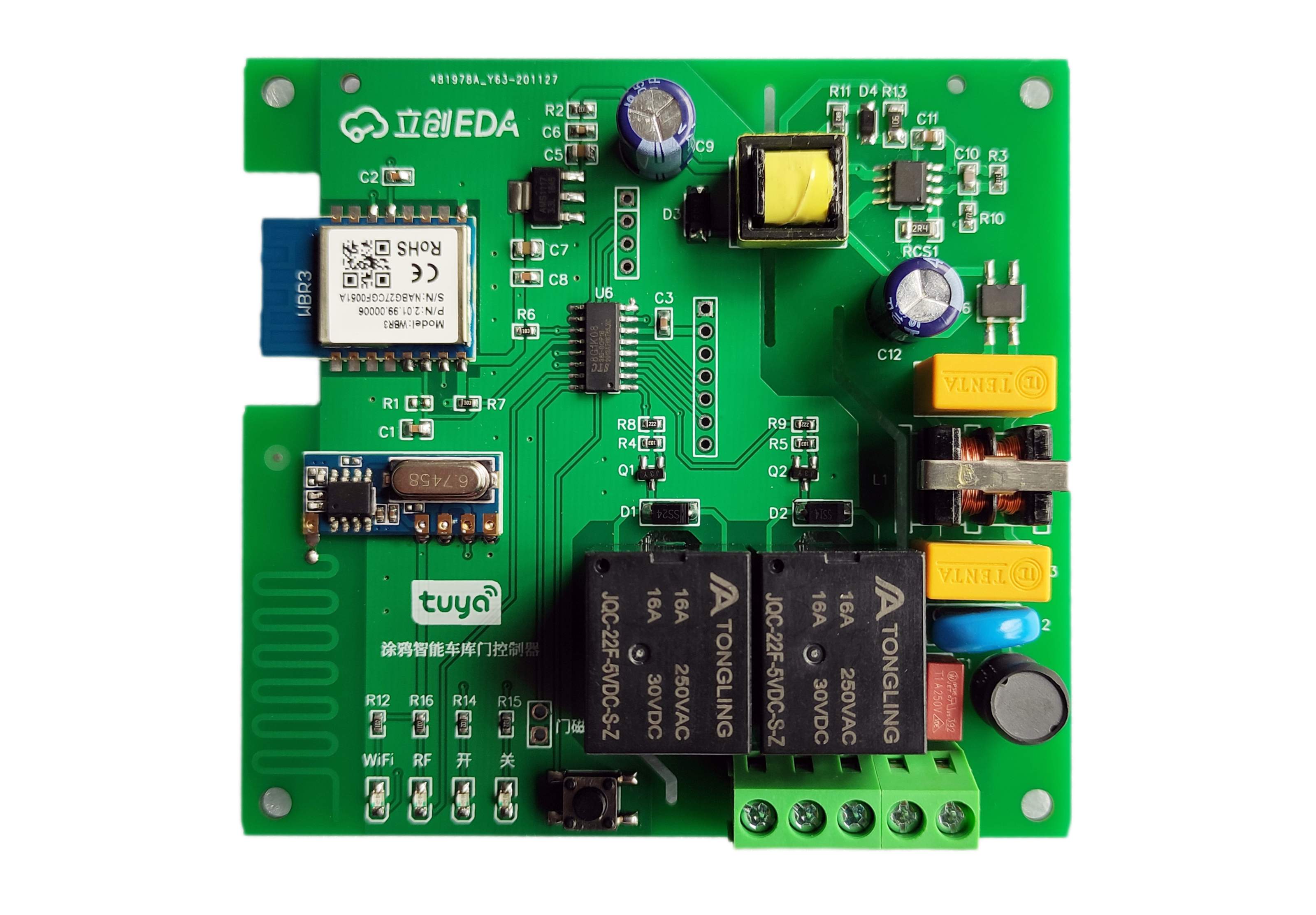

      The equipment uses Tuya WBR3 module + STC microcontroller + RF radio frequency module. The microcontroller locally controls the forward and reverse rotation of the motor to realize the electric door switch. The Tuya WBR3 module realizes mobile phone control.
1. WIFI module: Tuya WBR3 module is connected to the IoT platform.

2. Main control chip: MCU STC8G1K08 receives Tuya module instructions, decodes the remote control, and controls 2 relays.
         The microcontroller program was too difficult for me. I changed it and then tested it. When the test found problems, I changed it again. It took me 7 nights to write the code. The microcontroller can receive instructions from the Tuya module and send the door's opening and closing status. It also needs to decode the key code instructions of the remote control module and control the 2-way relay to realize the forward, reverse and stop of the motor. Attached is the microcontroller program code.
MCU data download address: http://www.stcmcudata.com/STC8F-DATASHEET/STC8G-STC8H-SELECT-GUIDE-20201027.PDF
3. Remote control module: JR43B wireless 433M remote control receiving module.
4. Power supply part: 220V power supply output 5V1A, LDO uses 1117 to output 3.3V.

5. The relay output circuit uses a stable and mature triode to drive two 16a high-power relays.
Wiring instruction diagram
       I originally had an idea to change the garage door at home into a mobile phone smart remote control. This time there happened to be an EDA IoT practical training camp event. After more than 10 days of hard work, drawing circuit boards, soldering circuit boards, and constantly rewriting the code, I finally succeeded. I am so excited. Please give me more suggestions. We will work hard to make practical products, and the next step will be mass production. Thank you Lichuang and Tuya for supporting this event! We will carry out more activities like this in the future.
