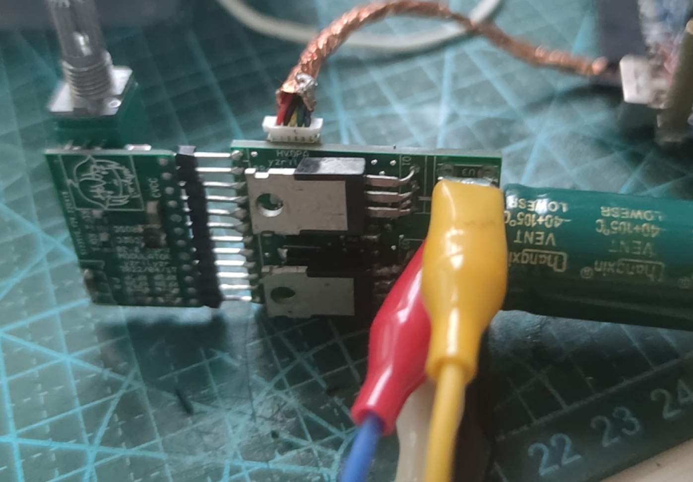

Discrete power stage low cost high power class D amplifier
Dual TL494 works in the master-slave (Master&Slave) mode. The BD/1SPW modulation
feedback uses differential feedback, and the input also uses differential input. At the same time, the startup impact is suppressed.
The power stage is driven by EG2132 (cheap and sufficient), and 4 MOS tubes form a full bridge. output, making power utilization more efficient
