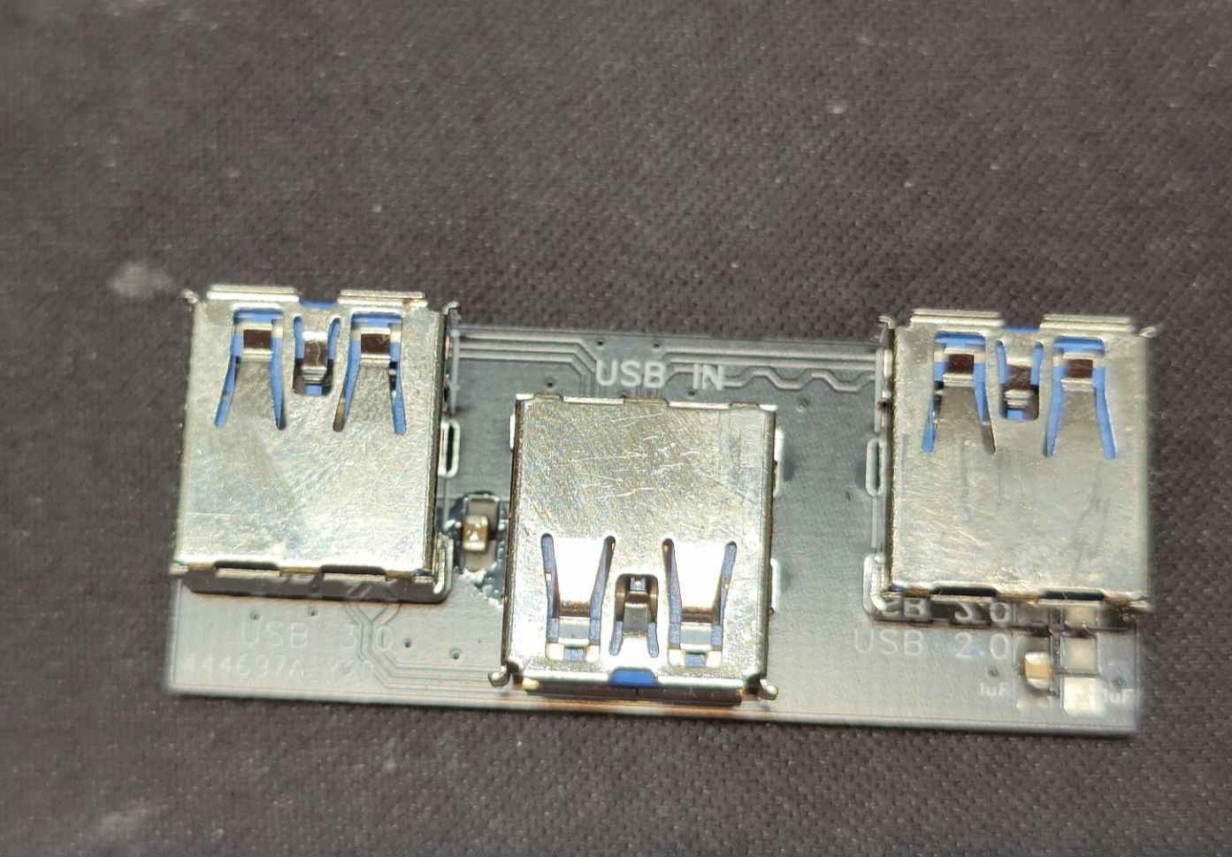

usb3.0 split 2.0+3.0
By splitting usb3.0 into independent 2.0 and 3.0 interfaces to improve its utilization (wireless mice and other devices are connected to 2.0, card readers, USB flash drives, hard disk boxes, etc. are connected to 3.0).
It should be noted that the line requires rx, tx reversed ones (general lines are all)
use 3.0 sockets to reduce the purchase cost and quantity of materials.
I don’t know why I can’t see the pcb and schematic diagram. I have packaged the files and put them in the attachment.
