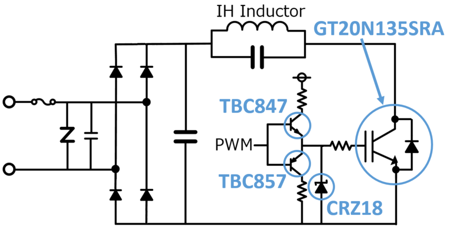

IH induction cooker inverter circuit

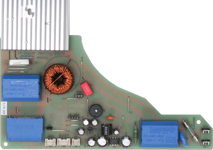

This reference design provides design guidelines, data, and other content for an IH induction cooker inverter circuit based on voltage resonant soft switching. Description Input voltage AC 200V to 240V Output power 100W to 2000W Circuit topology Voltage resonance soft switching characteristics of IGBT Induction cooker inverter circuit diagram Maximum output power: 2000W Overall size: 205mm×110mm Ideal IGBT brings low EMI noise
