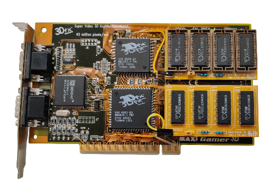

PCB for clipping onto Guillemot MAXI Gamer 3D Voodoo graphics accelerator. The common memory size for these cards is 4 MB. With the help of PCB you can get Voodoo up to 8 MB. A wire needs to be soldered to TMU pin 130 and connected via 47Ω to pin 14 of the upper memory row. J1 needs to be shorted (closed). The FBI chip requires two wires from pin 180 and pin 199. Both wires need to be connected to the PCB with J1 open.
