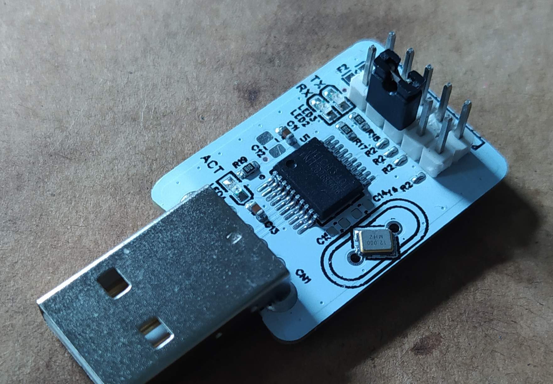

CH340 is a USB bus adapter chip that realizes USB to serial port.
● Full-speedUSBdevice interface, compatible withUSB V2.0.
● Simulation of standard serial ports, used to upgrade original serial port peripherals, or add additional serial ports through USB .
● The serial port application program under the Windows operating system on the computer side is fully compatible and does not need to be modified .
● Hardware full-duplex serial port, built-in transceiver buffer , supports communication baud rate 50bps ~ 2Mbps .
● Support DTR , CTS and other signals .
● Built-in firmware and software are compatible with CH341 , and you can directly use the VCP driver of CH341 .
● Supports 5V power supply voltage, 3.3V power supply voltage and even 3V power supply voltage .
● CKO clock output .
