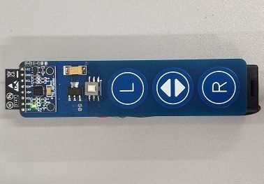

Bluetooth air mouse
A Bluetooth air mouse made with ESP32 and MPU6050 can control computers and smart TVs.
I first verified it with a breadboard and the effect was okay, so I drew a board and powered it with a lithium battery for easy use.
Program: https://github.com/gavin9399/Air_Mouse
