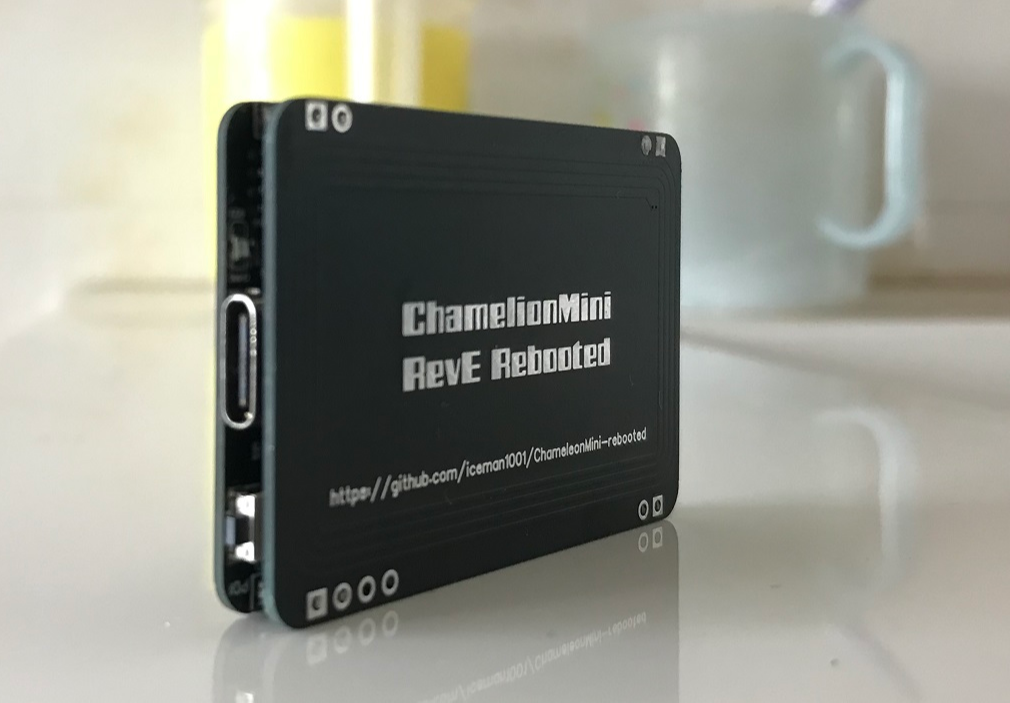

ChameleonMini is based on a piece of hardware for multi-band and multi-type RFID simulation designed by a German university when studying RFID security. Realize functions such as M1 card simulation and key sniffing.
After being open sourced, ChameleonMini branched into G version and E version. The E version was modified by the big guys and developed into ChameleonMini RevE Rebooted.
This design mainly refers to the project released by iceman1001 on github. I made some modifications based on the components on hand and the actual debugging situation:
I have released the Chameleon Mini before . The board is relatively large, and the positive electrode of the battery and the TYPEC socket (ground) are relatively prominent. If it is carried with the key, it is easy to short-circuit, so I made this version.
Main features:
1. It is composed of two boards: the main board layer and the antenna layer. The two layers are connected by plugging or welding;
2. All components are wrapped by two boards and are not exposed, effectively solving the risk of short circuit;
3. Compact size : Size 54mm*36mm*6mm;
4. The circuit is almost the same as ChameleonMini , except that the antenna has been redesigned, the area is greatly reduced, the number of hits is increased, and the total inductance is consistent with the original antenna. The measured signal is stable.
Soldered motherboard:
Assembled (since the short-pin connector has not yet arrived, this one only has the antenna connection terminals simply soldered for testing, and the others are all virtual connections)
Compared with ordinary water drop-shaped access control cards, the size is not too large:
The 8 LED lights used for display when the card is switched are designed to be side-mounted, but I soldered ordinary 0603 packaged LEDs, and I can see clearly:
Using TYPEC uplink computer, the power supply and selection switch are side-mounted (2*4*3.5mm, this switch feels average)
Back of the motherboard: In order not to affect the signal, it is recommended not to apply copper. I signed a name on the solder mask. You can remove it if you don’t like it when making the board.
