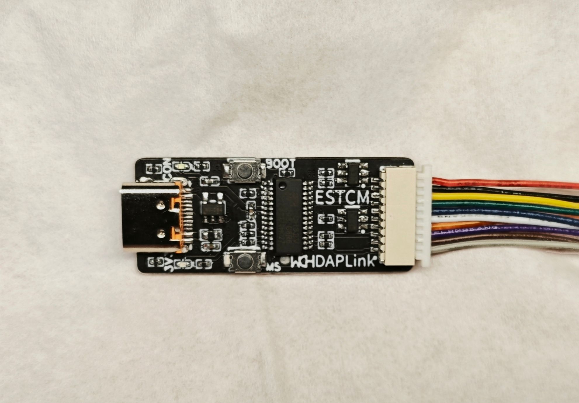

WCH-DAPLink Femto Mini ARM Debugger
WCH-DAPLink Femto
redraws the board based on the official schematic.
The SH1.0 output interface
size is only 36x15mm.
Before downloading the firmware, press and hold BOOT to power on and
use WCHISPTool to download the USB firmware.
Chip selection CH32V203.
Download tools, firmware, and official manuals are all in the attachment.
