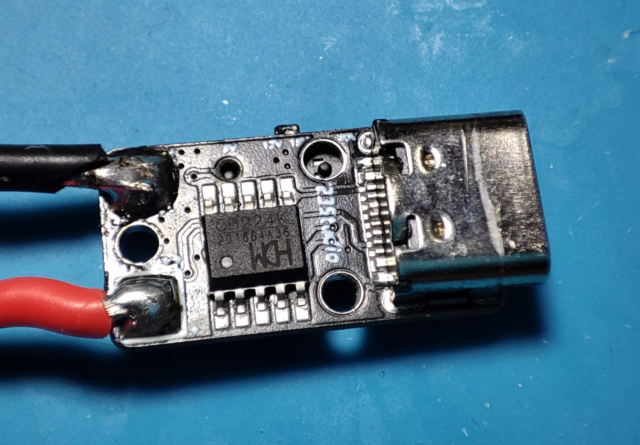

Type-c multi-position Mini decoy device
The Type-c multi-position Mini decoder CH224K
has an area of ​​only 10.5*20mm. It is very compact and can be placed on any module for use.
Using CH224K deception chip and multi-level DIP switch, it supports 9V 12V 15V 20V one-click deception.
In order to avoid damaging the power receiving end equipment, please set the lever to the required position before powering on.
When using the lever with power, if it is not moved quickly, it will be left empty and placed in the 20V position.
