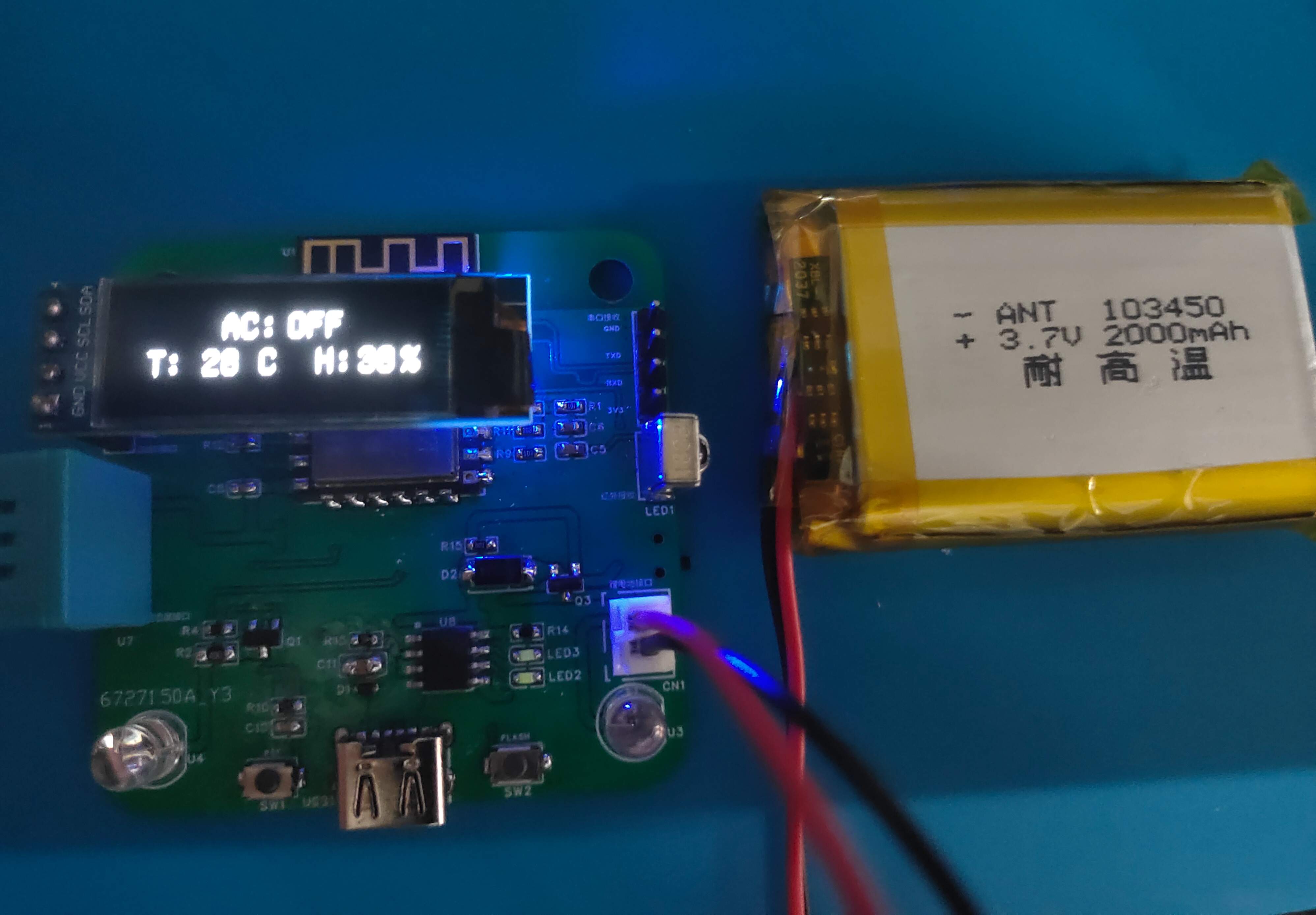

This project is just the beginning now and will be gradually improved later. There will be more explanations. I hope you can join the communication group: 678911291
Version V2.0
adds a lithium battery power supply circuit and is compatible with Type-C Charging and power supply.
The two infrared emission tubes under the OLED screen are subtracted and replaced with positioning holes, and a shell design is added to the back.
The original program is compatible with Dian Deng Technology (the attachment below has been open sourced)
and the mqtt docking with Alibaba Cloud server solution has been added. Android Studio has developed a simple host computer implementation function (this solution is not open source yet):
V1.0 version
hardware description:
The main control is Anxinke's ESP-12F module (WIFI module is connected to WIFI and connected to the DianDeng technology platform)
1 infrared receiver (used to receive infrared signals, recorded and used)
4 infrared transmitting tubes (used to emit infrared to achieve control effects)
1 DHT11 sensor (used to detect the temperature and humidity of the environment)
1 0.91-inch OLED screen (used to display temperature and humidity data and air conditioner switch status)
2 turtle buttons (used to reset and burn codes)
Release V2.0 on 2023.6.9
Release V1.0 on 2023.3.9
V1.0 physical picture:
V2.0 physical picture:
Demonstration video:
