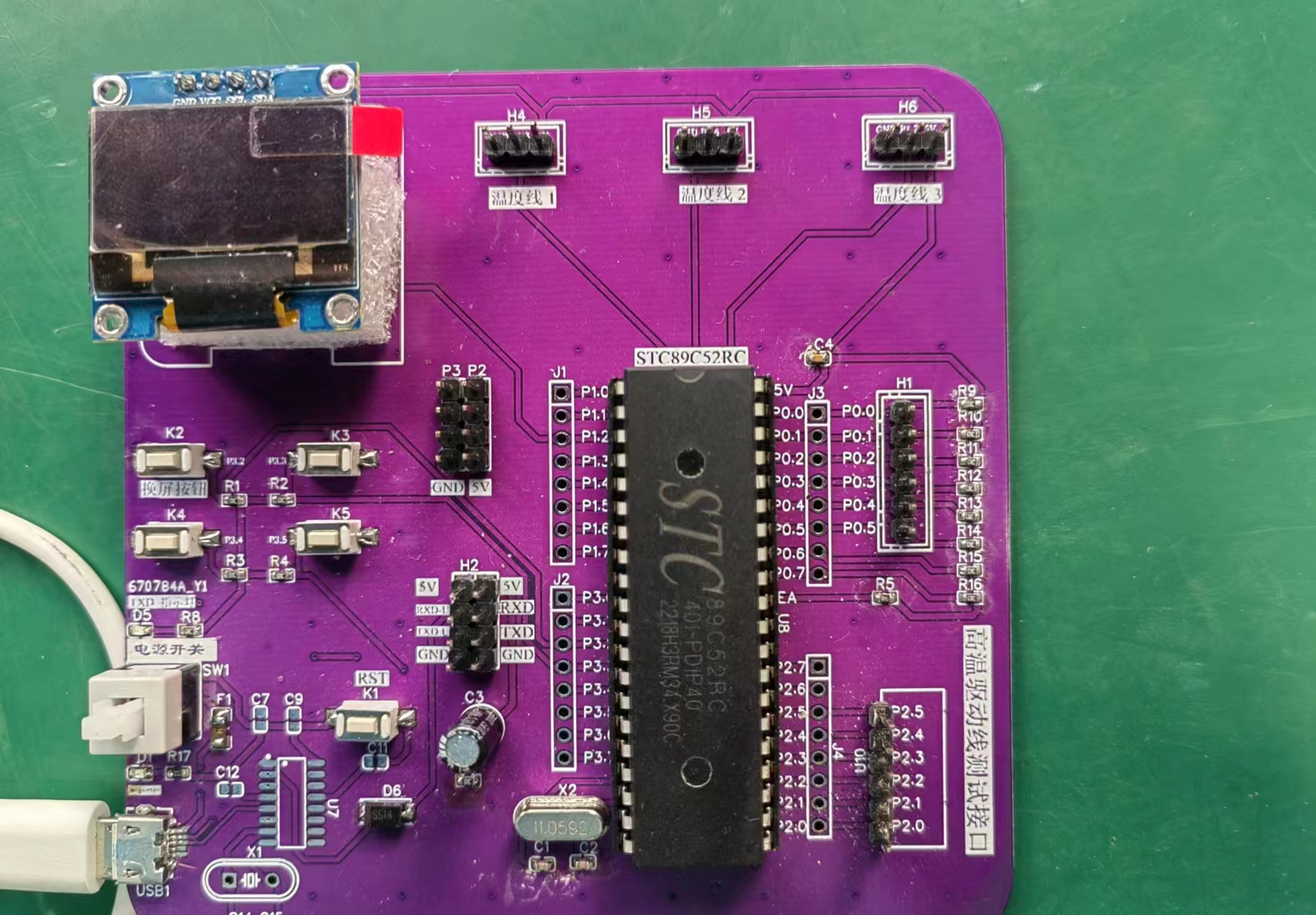

Project Introduction
        An accidental work opportunity allowed me to try to draw schematic diagrams and PCBs. I designed this with reference to some materials and microcontroller principles. It simultaneously read the temperatures of three DS18B20s and realized the sequence of six line segments through button switching and measured whether they were connected or not. .
The schematic diagram shows
       that STC89C52 is used as the main control. 1. The temperature of the DS18B20 sensor is read through the three I/O ports P1.5, P1.6, and P1.7 and displayed on the OLED. 2. Use the button to switch to the line measurement program, and use the six wires connected to the terminals to determine whether the six wires cross and whether the connectors are open due to poor contact. The serial port programming circuit and crystal oscillator circuit are modified based on the actual needs on the Internet.
PCB description
      The PCB adopts the default wiring rules of Lichuang. The line width and layout are completed by querying cnds and learning the open source projects of Lichuang friends, and are drawn based on the knowledge learned.
In the software description,
     I quoted the routine c52 microcontroller to read the ds18b20 basic change.
#include "reg52.h" //This file defines some special function registers of the microcontroller #include "temp.h" #include "temp1.h" #include "temp2.h" #include "oled.h"
typedef unsigned int u16; //Declare and define the data type
#define led1 P2#define led2 P0sbit k1=P3^1; //Define the P31 port as k1sbit k2=P3^2; //Define the P31 port as k1sbit test=P0^0 ;//char num=0;u8 DisplayData[8];u8 DisplayData1[8];u8 DisplayData2[8];
