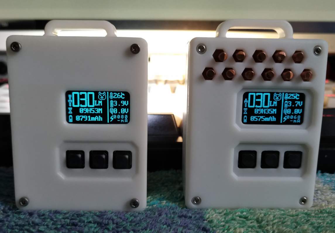

Shell changes:
The upper shell adds heat dissipation holes, using 0.8mm copper plate and 3*5mm copper rivets, and soldering them together with solder paste heating plates to make a heat sink.
The upper shell screw position has a column, which can reduce a set of copper columns. The upper shell is thickened to 3mm, not easy to deform, and the fixing screw countersunk hole can be sunk.
The lower shell and the lens position have fixed protrusions, which will not turn around during installation. The lower shell is also deepened by 2mm, and the screw column is shortened to accommodate a larger battery.
It is still printed on 3D Monkey, using 8111X resin, which is temperature resistant to 59 degrees. It feels good.
It is recommended not to polish the option. It is better to polish it yourself.
