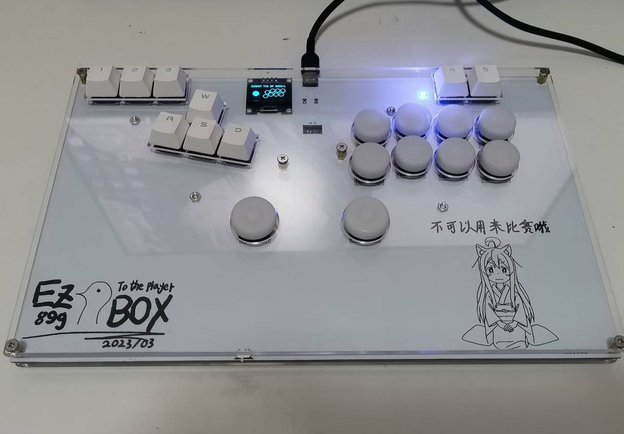

HITBOX improved version
Using the hitbox layout as a reference, the key position of the right strike key has been optimized, shortening the key distance and key cap area, making it easier to feel tired after playing for a long time.
The microcontroller development board uses Raspberry Pi pico, and the firmware can be used https://github.com/OpenStickCommunity/GP2040-CE.
Two thumb function keys have been added, and the left function key can be switched with a switch.
