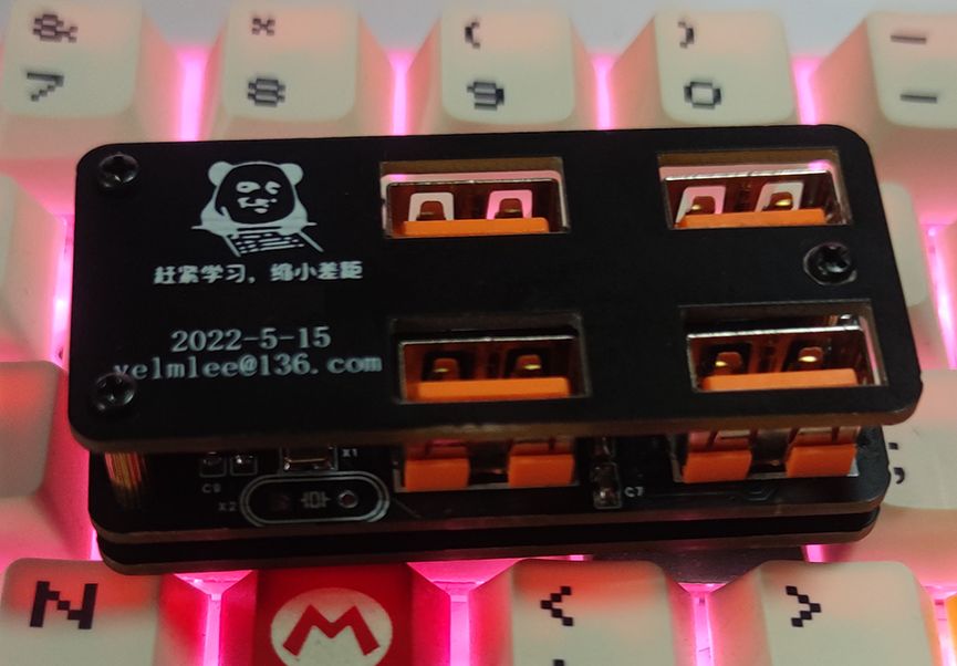

Friends who play electronics know that the USB ports of computers are simply not enough, especially those with thin and light laptops. There are only 2-3 USB ports. After plugging in a keyboard, mouse and other devices, there are no usable USB ports. Frequent plugging and unplugging can easily cause the USB port to become damaged. It's loose, sometimes the cable isn't long enough and it's annoying, and the USB port is easily damaged (don't ask me how I know, because I've already lost a 3.0 USB port). I bought a USB2.0 hub before, but the USB port is easily damaged. Two USB devices are unstable. In order to solve this problem, a one-to-four USB2.0 hub was built based on the SL2.1A chip. (I’m so miserable that I’m still changing my board in the dormitory at 520)

  • Since most of them use type-c and Micro (referred to as Android data cable) data lines, type-c and Micro female sockets are added. At the same time, the SMD crystal oscillator package: SMD3225 and the in-line crystal oscillator package: HC-49S are reserved. Just install whatever crystal oscillator you have! In order to reduce the difficulty of welding, the capacitor packages are all in 0805 package.
Note: Copper pillar size: M2*10MM (double-pass circular knurled copper pillar); M2*3MM (single-head single-pass knurled copper pillar)
Screw: M2*3MM
Final product picture
