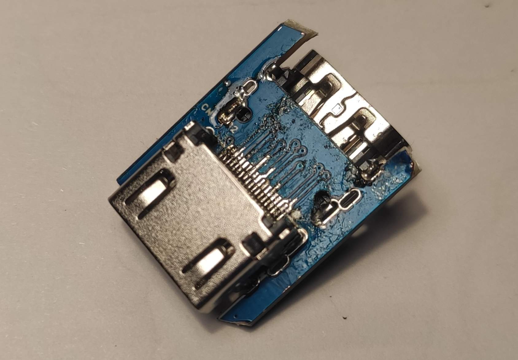

HDMI-A lying female base to female base
The very small HDMI-A horizontal mount female base
supports two types of HDMI female bases, long and short. The excess length can be cut off and then protected by heat shrink tube. It is recommended to modify it before printing. SMT patches and manual steel mesh are recommended, otherwise welding will be difficult.
It is used in scenarios where the combined line is not too long. Some experts pointed out that if it is larger than 3 meters, adding a chip will have a better effect.
PS: It is really difficult to solder with a short soldering iron...
