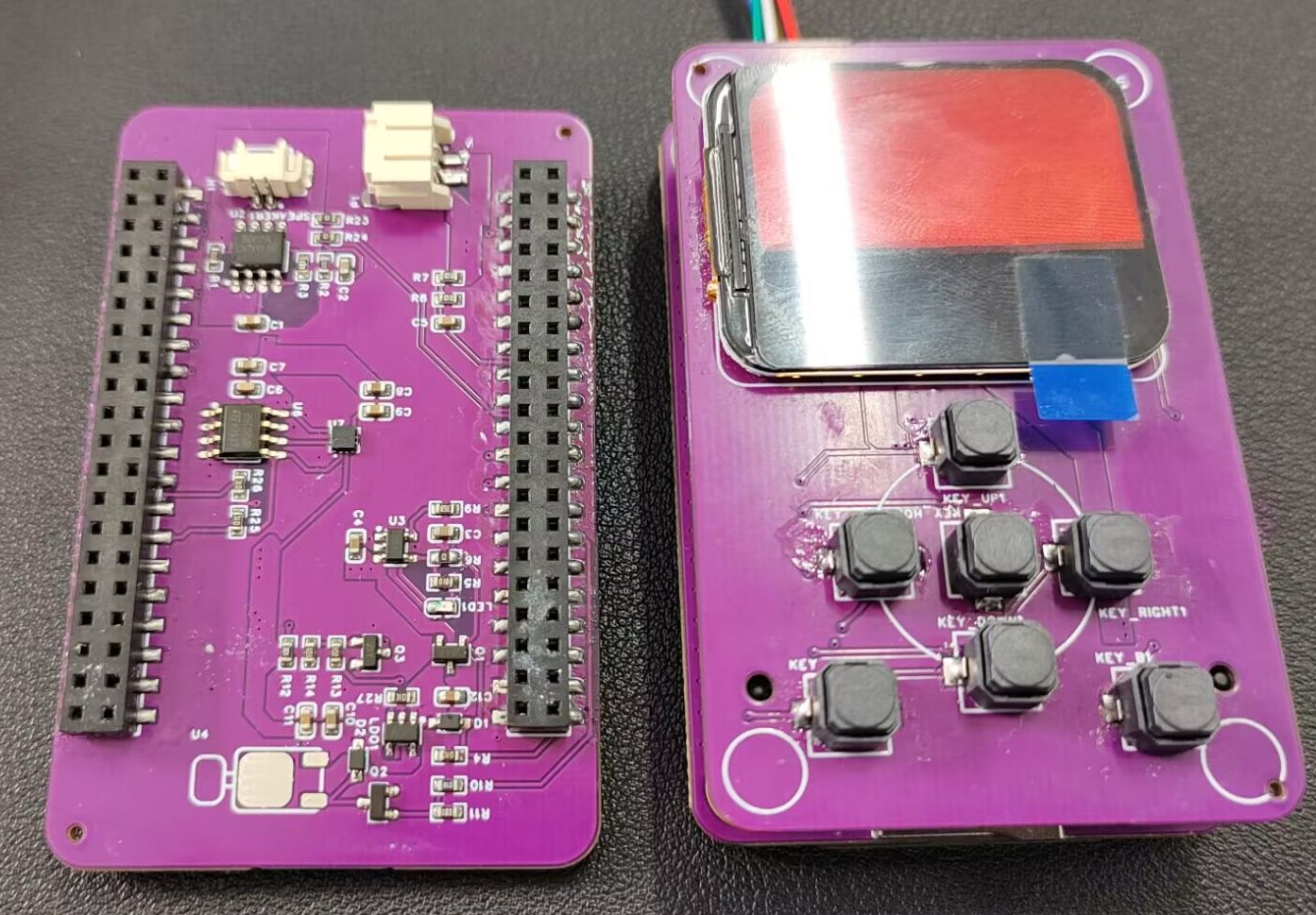

## 4 Actual picture
![QQ图片20230521200152.jpg] ![QQ图片20230521200147.jpg] ![QQ图片20230521200140.jpg]
## 5 PCB design description
I'll just put the picture, mainly the copper of the audio signal was processed, and nothing else seems to be done.
