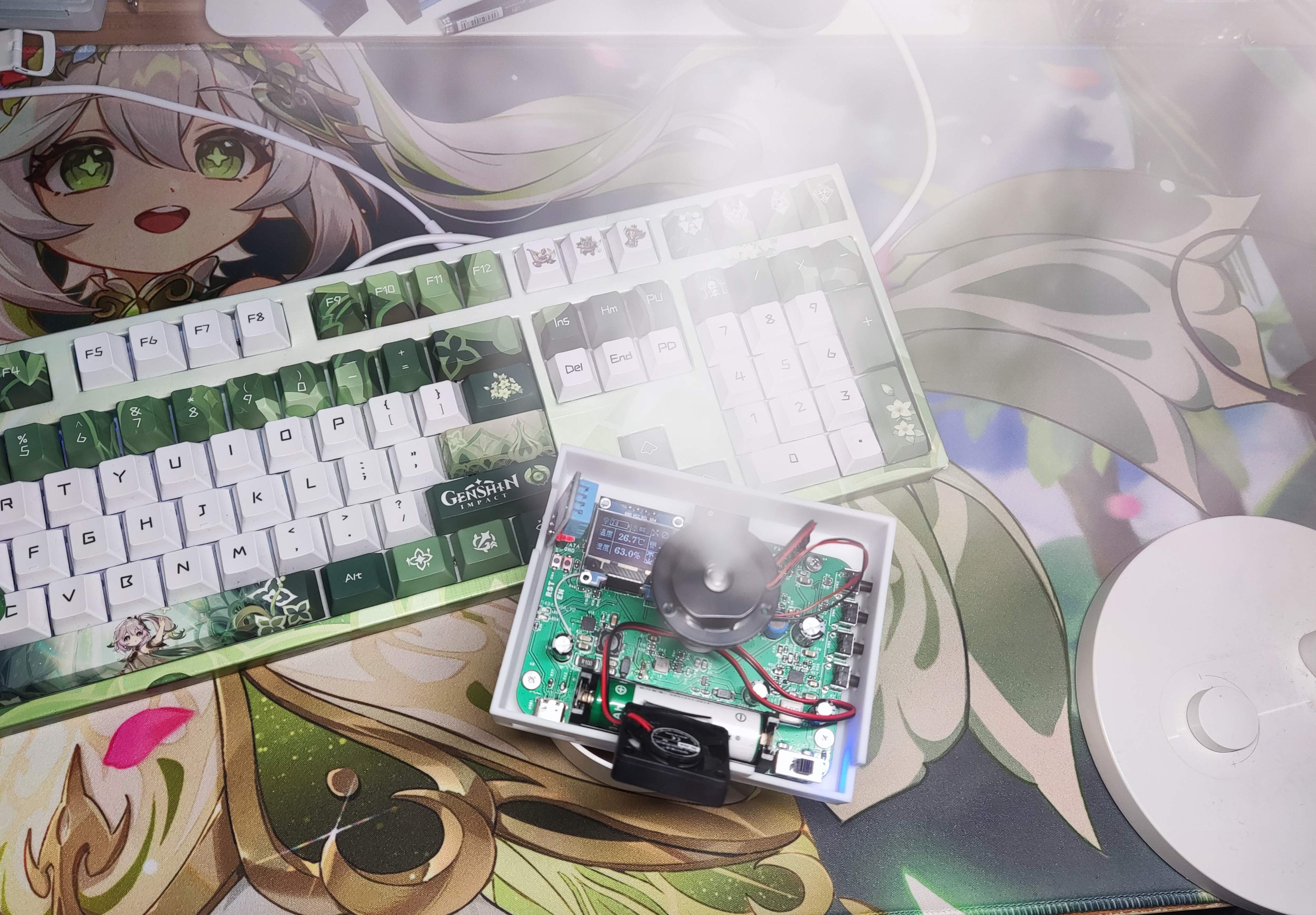

With the development of Internet of Things technology, smart home has gradually become a new trend in people's lives. In this field, humidifiers are not only the key equipment to solve the problem of indoor dryness, but also a very good scene to demonstrate the application of Internet of Things technology. Therefore, I decided to make an intelligent humidifier based on ESP32, integrating hardware modules and developing software to achieve a more intelligent, accurate and convenient indoor air humidity adjustment solution. Before designing, I will comprehensively analyze the humidifier products on the market, study popular Internet of Things platforms, and investigate the best hardware equipment to determine the design plan. This humidifier not only realizes the intelligent adjustment of indoor humidity, but also pays attention to user experience and data display. Therefore, the design includes the full-link implementation from hardware to software, such as water level sensor, temperature and humidity sensor, circuit board design, motor drive circuit, water tank temperature management, lighting platform, APP, etc. I hope that this project can not only provide convenience for solving practical problems in people's daily life, but also provide reference and inspiration for more Internet of Things developers, and explore the infinite possibilities of the development of Internet of Things technology together.
Humidifier effect
Using ESP32 as the core of the Internet of Things, an intelligent Internet of Things humidifier that can be adjusted according to external temperature and humidity.
It comes with a water level detector, which will prompt when the water level is insufficient.
It comes with an OLED screen that can display temperature, humidity and water level information.
It comes with a motor drive circuit to fan out the water vapor better.

5V is passed through the U8 triangle inductor, one of the pins is connected to the MOS tube, IO2 is connected to ESP32, and high-frequency PWM is issued through ESP32, so that the voltage output is about 60V (similar to inversion), thereby driving the ultrasonic module to work. The ultrasonic module wiring is located in U2

uses a MOS tube to drive the motor to fan out the water vapor. The fan interface is in U6, with positive on top and negative on the bottom. The speed can be controlled using IO16's PWM.

The oscilloscope waveform is as follows
. It should be noted that the humidifier needs to be plugged in to turn on this 108k PWM, otherwise the AO3400 tube will be damaged.
