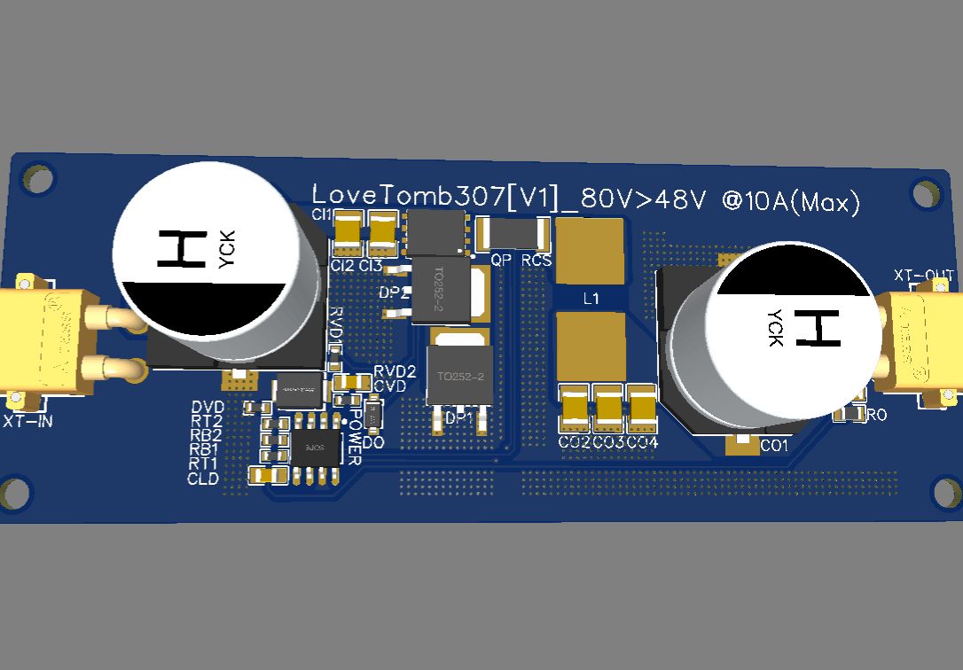

The default design is 80V to 48V
In fact, the MOS withstand voltage is 100V, while the IC can work under 150V input
Therefore, it is recommended that the input be between 60-80V (as for the input MIN voltage, it depends on actual testing)
Output current maximum 10A
The inductance theory requires 369UH, I think it has been verified
All input and output use XT30
The circuit is BUCK non-synchronous rectification (so the heat is huge) and the output is within 5A.
