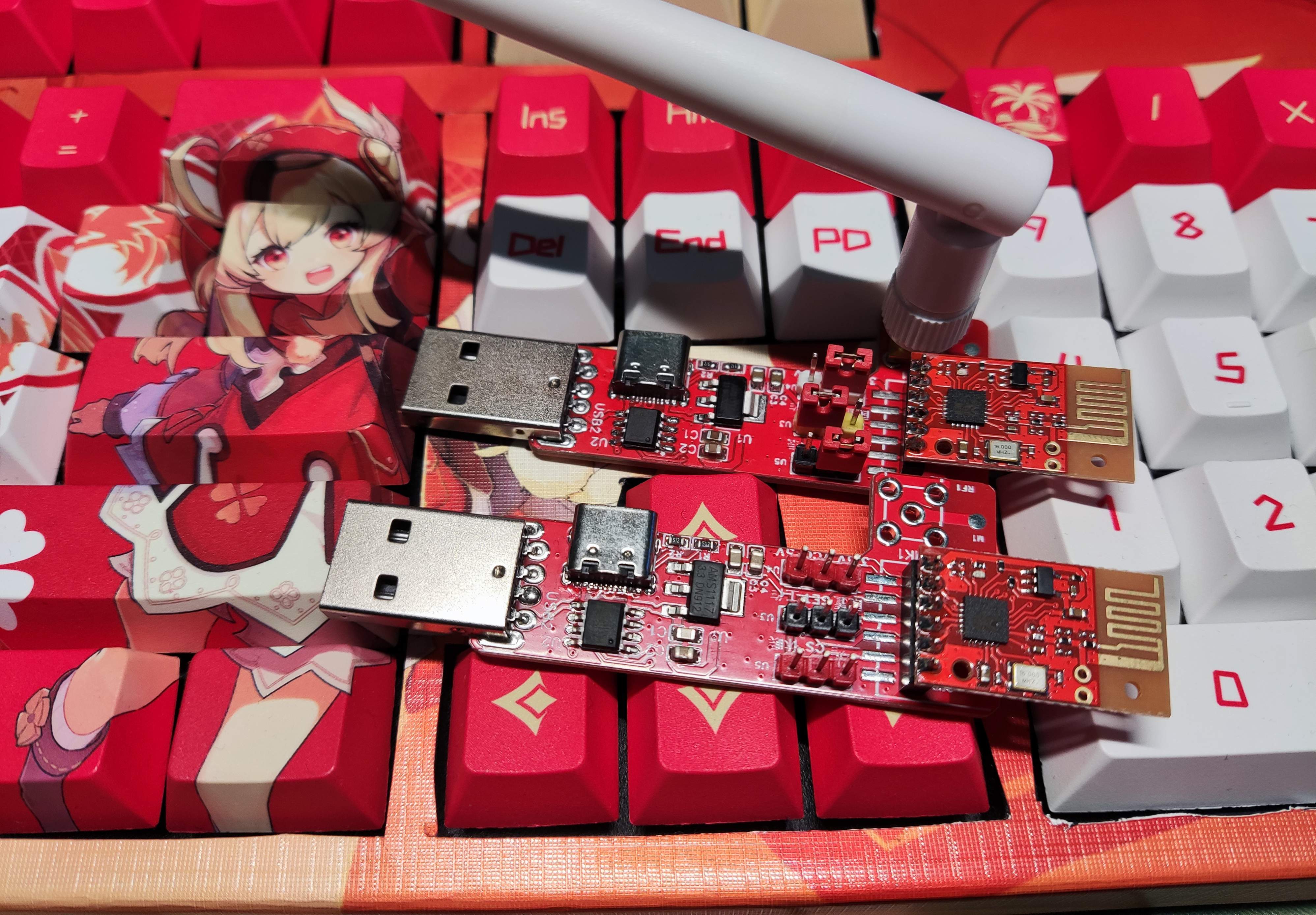

1. Introduction
Note that the 5V jumper is reserved. Most serial port transparent transmission modules only need 3.3V. Connecting 5V will damage the module! ! !
The Hummingbird wireless module serial port adapter board on Taobao
supports LC12S and Ling TR, and can transmit 100m and 1km via serial port.
See the previous farmland environment data wireless collection irrigation self-discipline system:
https://oshwhub.com/aknice/nong-tian-shu-ju-wu-xian-cai-ji-zi-lv-xi-tong-ji-yu-rui-sa-mcu
. The two combinations can be made into a one-receive and one-transmit serial port mutual transmission, and can be set to send multiple or receive multiple.
