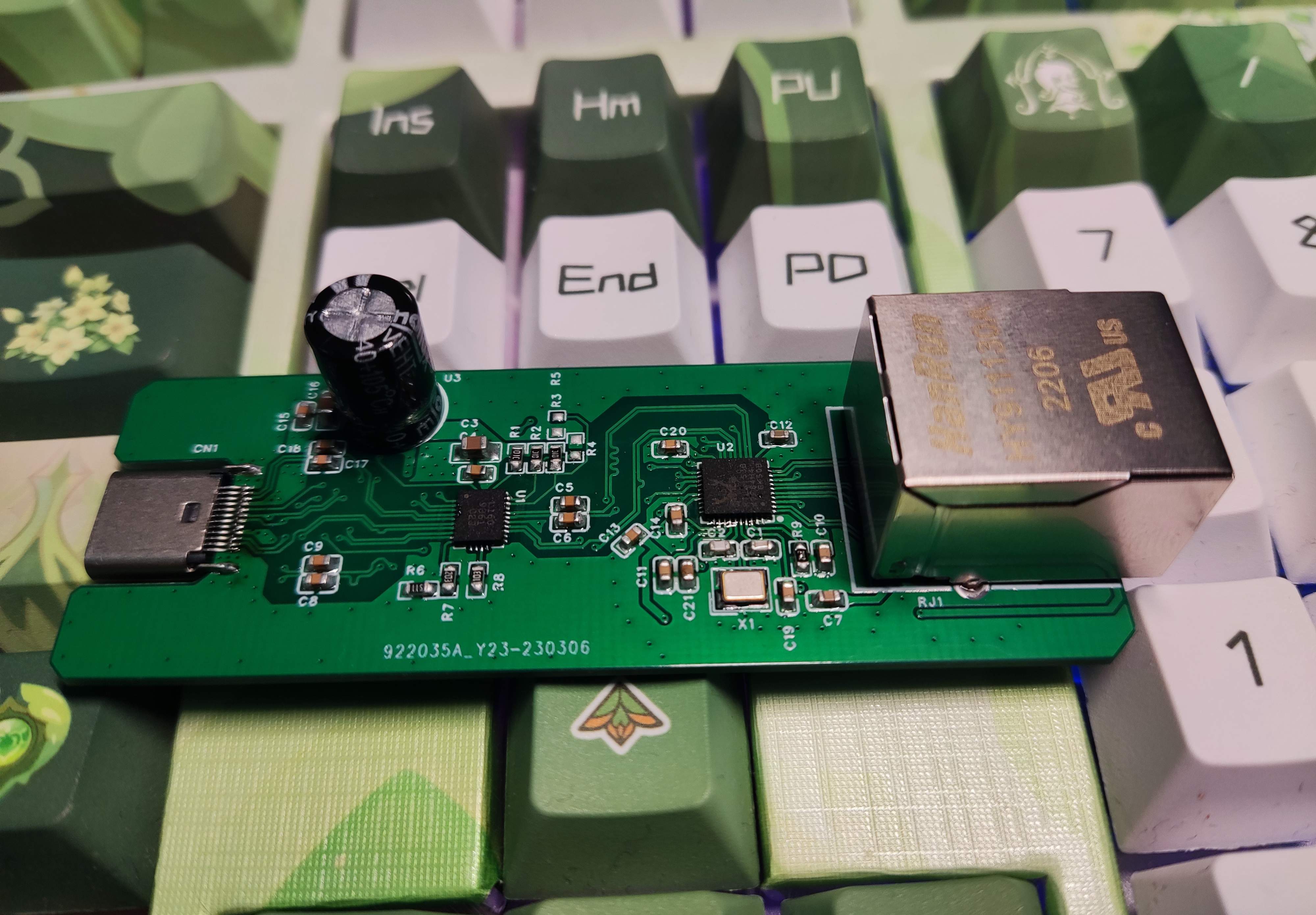

TYPE-C RTL8153B Gigabit USB3.0 network card
1. Introduction:
This project refers to the project of @Kirito boss
https://oshwhub.com/Kirito/usb3-0-wang-ka-rtl8153b.
It only adds USB3.0 TYPE-C part of the circuit and optimizes
the Gigabit USB3.0 of RTL8153B. Network card
RTL network card tool EFUSE reference
https://www.docin.com/p-750111697.html
2. Improvement suggestions
1. The heat is great during gigabit transmission, the bottom of the recommended heat sink
is hotter, and it is recommended to increase the bottom pad position Open windows and the number of vias
or install a four-layer board (it’s no use anyway) to increase the heat dissipation effect
. 3. The actual measurement
can identify the Gigabit
download speed. Due to operator restrictions (the network speed is not fast), you can try the bridging effect.
