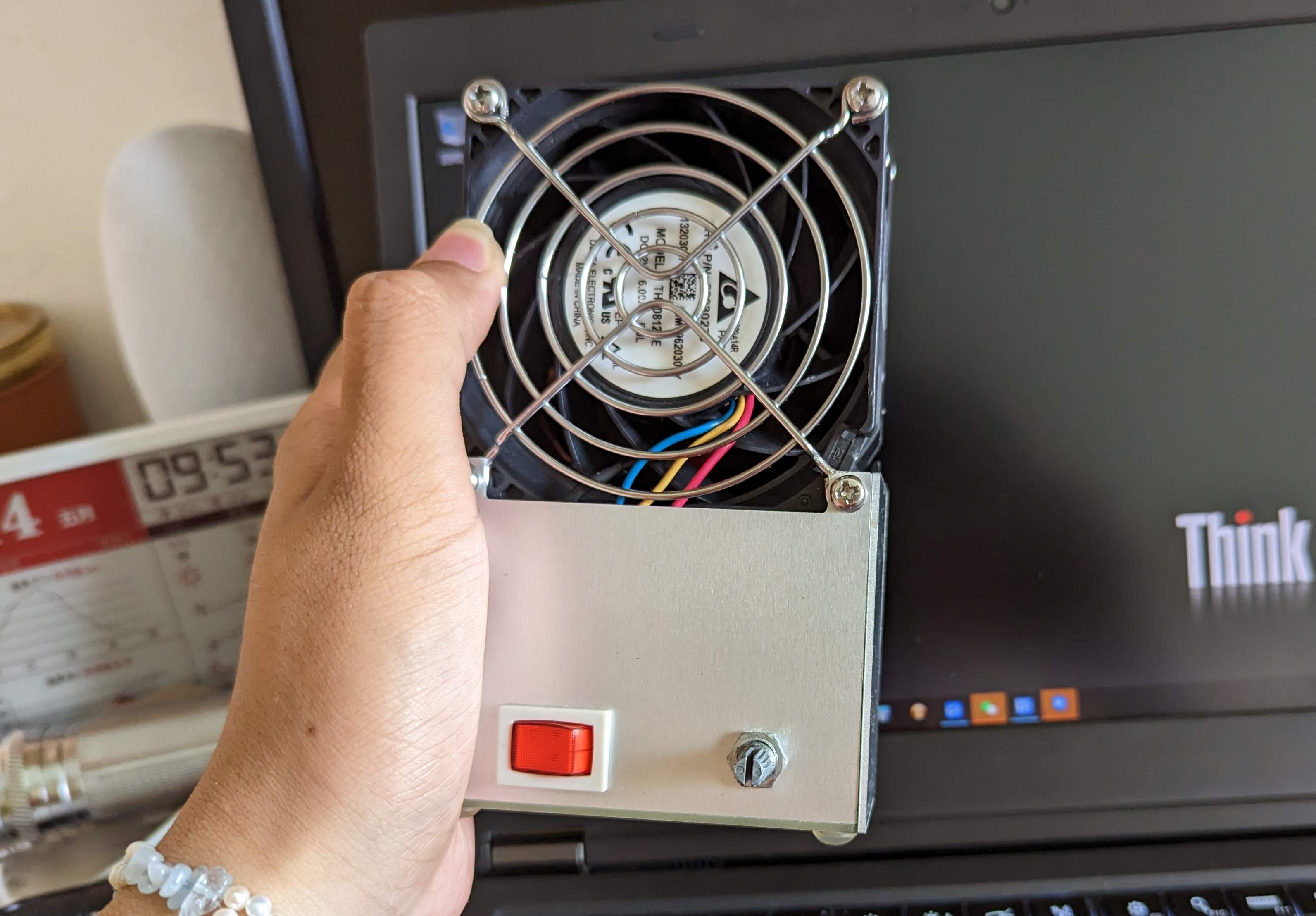

Delta 8cm server fan modified housing
Use 1.6mm PCB, fiberglass board as the bottom surface, and aluminum substrate as the panel side panel and back panel.
Use welding and gluing to secure.
Use screws to secure the fan + protective grille.
The size was measured by me, and it has been used for nearly two years without any problems.
