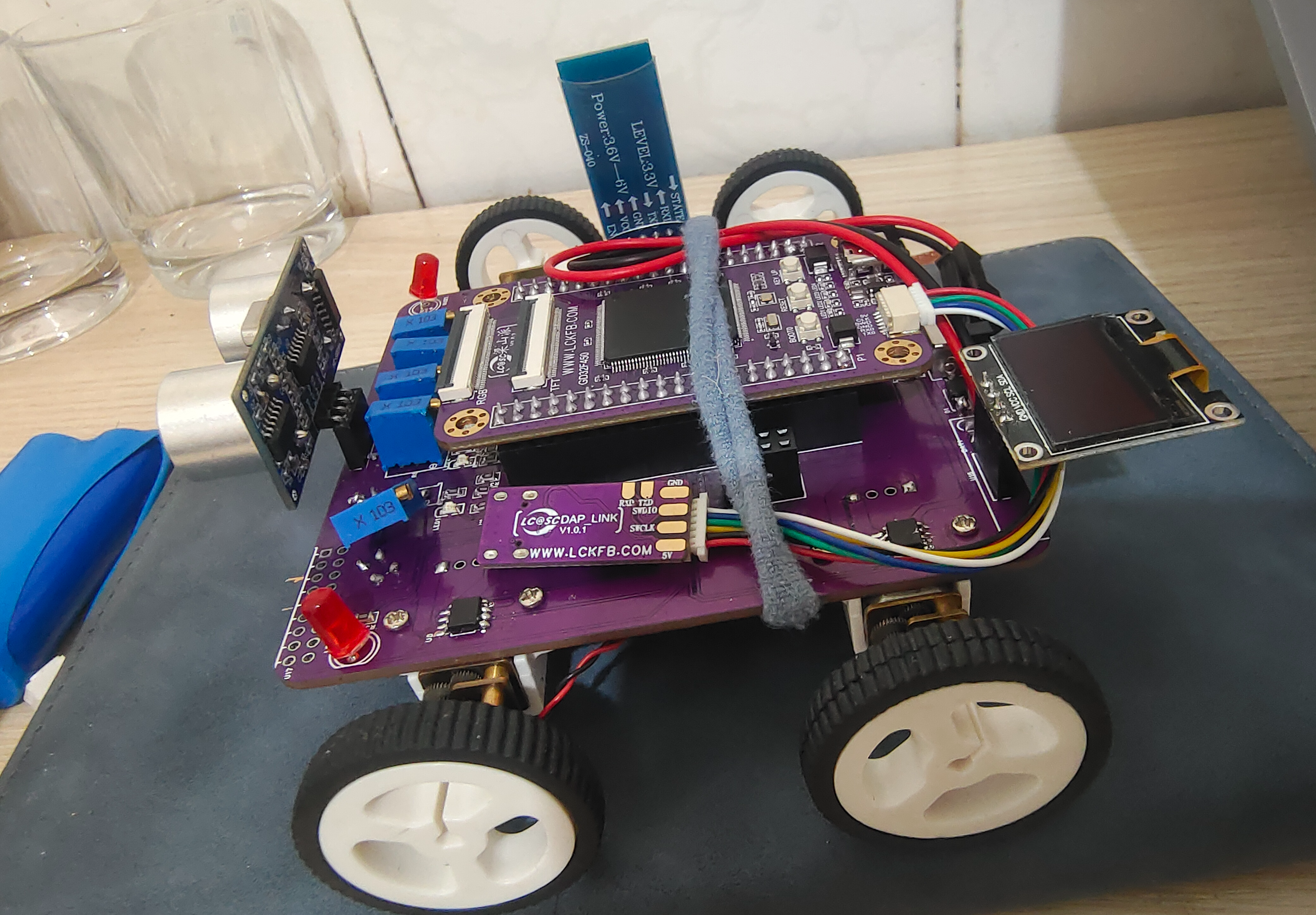

Liangshanpai smart car
# 1. Appearance display
! [IMG_20230701_205728.jpg]
# 2. Goal:
Be familiar with the development process and learn circuit design.
# 3. Function introduction:
button switching mode, buzzer reminder, OLED display, tracking, Bluetooth control, obstacle avoidance.
Camera and handle remote control will be added later.
# 4. Skill mastery.
I learned how to efficiently read data manuals, consult relevant information and bug fixing related knowledge, etc. The focus is on the process of finding information and fixing bugs.
# 5. Pin definition
UART:
HC-05 UART6(RX:PF6;TXPF7)
SPI:
2.4G SPI3 (SCK:PG11;MISO,PG12;MOSI,PG13;NSS,PG14)
IIC:
OLED IIC0 (SDA,PB7;SCL,PB6)
PWM:
TIMER1_CH0 PA0 TIMER1_CH1 PA1 Right rear wheel
TIMER1_CH2 PA2 TIMER1_CH3 PA3 Right front wheel
TIMER2_CH0 PB4 TIMER2_CH1 PA7 Left front wheel
TIMER2_CH2 PB0 TIMER2_CH3 PB1 Left rear wheel
