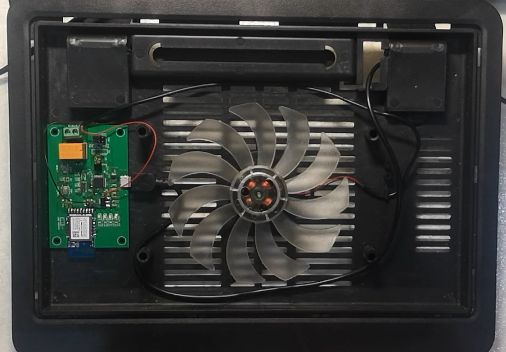

I soldered two boards in total. I was thinking about what to do if I didn’t have a soldering iron at home. I didn’t expect to win the yellow flower 907 during the live broadcast. However, I hardly soldered boards during college. I quickly watched the soldering iron patch soldering tutorial on LiChuang EDA B station, bought a cutter head online, and started my first work. . . .
After the first board was soldered, the serial port could be detected. After a while of joy, I found that the LED light was not on. . . My mentality exploded. I tried the relay and it worked, but this LED did not light up. I didn’t know what went wrong, after all, I was a novice in soldering. So I started to solder the second board. Fortunately, I bought two sets of components, otherwise I would be dead. After the second board was soldered, the LED light was on!! But one of them was not on, so I started to tinker with it. After all, I only had this board. I checked and found that the resistor next to the LED light was soldered on one side, and the other side was not soldered to the pad. After the LED light problem was solved, I found that the button was not working. . . . A closer look showed that it was a cold solder joint again, but it was fixed after rework. After the board circuit was adjusted, I felt relieved.
![image.png]
**The first failed product and the second finished product**

This course design - the smart switch based on Alibaba Cloud has been completed. Although there are still many shortcomings and deficiencies in the design, I have learned a lot from it. In this course design, under the professional guidance of LiChuang EDA teacher and personal learning, I applied knowledge such as circuit design and embedded software development, and had a deeper understanding of designing an IoT control system. I exercised my hands-on ability and the ability to develop engineering projects, and closely combined theory with practice. It will be of great help in the future work, study and life.
**Finally, I suddenly had the idea to use this PCB on the computer heat sink. **
**For detailed production process and effect, please see the video below~**
**If you are interested, there are also various functions to add, such as remote computer startup, remote monitoring of computer performance, or adding an oled to display computer performance temperature, etc. Hahahaha**
![QQ图片20200822235323.png]
