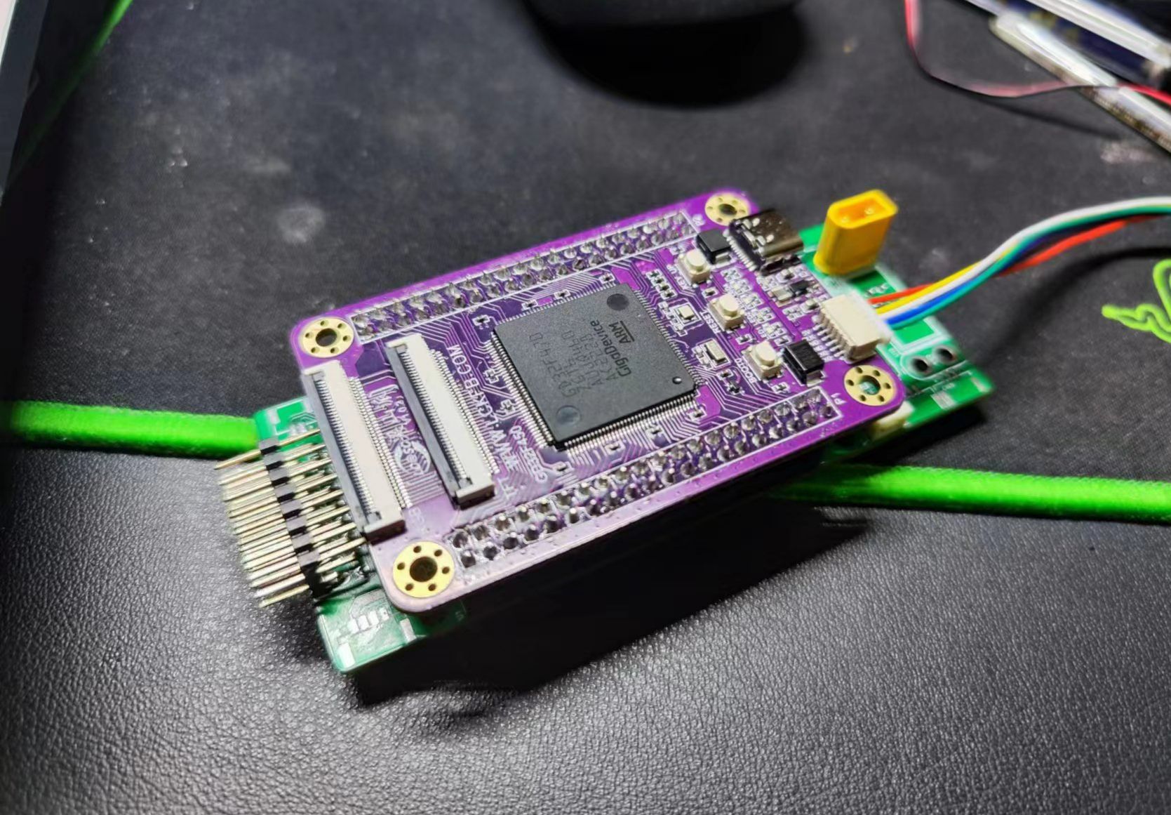

This project comes from the Lichuang·Liangshan School development board winter vacation training camp. Based on the Liangshan School, the RoboMaster main control expansion board is produced. Refer to the original factory [C-type board] (https://www.robomaster.com/zh-CN/ products/components/general/development-board-type-c/info) for circuit design. The expansion board expands 24V (6S battery) buck, USART, CAN, PWM, battery voltage monitoring and other functions, and can be used with the host computer to achieve visual control and other functions.
# Picture display
! [Screenshot 2023-02-13 144559.png] ![WeChat picture_20230223002400.jpg] # Function description

I tried Jialichuang’s four-layer board for the first time and had a good experience.
The patch feels great for a while, and the welding crematorium.
The power supply part of the 24V step-down circuit is equipped with one XT30 input and three XT30 output interfaces (24V). In order to adapt to the 6S power battery, a 24V step-down 5V~1.5A circuit (MC34063ADR2G) is designed to supply power to the core board and CAN chip through 1117_3.3 LDO; a 24V step-down 5V~3A circuit (TPS5450DDAR) is used to drive the rudder. machine, ESC, remote control receiver and other high-power equipment.
![image.png] ! Notice!
The 1.5A step-down circuit can step down the voltage by 5V, which can be used to charge mobile phones. However, it will cause power loss when the Liangshan pie is plugged in. This has not been ruled out yet. A 0R resistor is used to build two output capacitors, and the entire board is temporarily powered by 5V3A.
