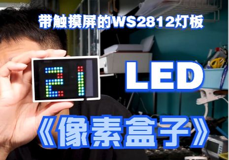

"Pixel Box" touch screen LED light panel
2020 packaged WS2812b lamp beads, 18X12 Z-shaped dot matrix.
The Hezhou esp32c3 development board is used as the main control and is directly attached to the back, and can also be connected with Dupont lines.
Black grid, 2mm thick dark tea acrylic sheet.
3.5-inch IC: FT6236U capacitive touch external screen connection address: https://item.taobao.com/item.htm?spm=a1z09.2.0.0.2a4f2e8dd6g6e9&id=627131226350&_u=r2oqo1kfc8fdFor
detailed introduction, watch the video directly at the video address: https ://www.bilibili.com/video/BV1h14y1f7uj/Upload
the code after sorting it out
