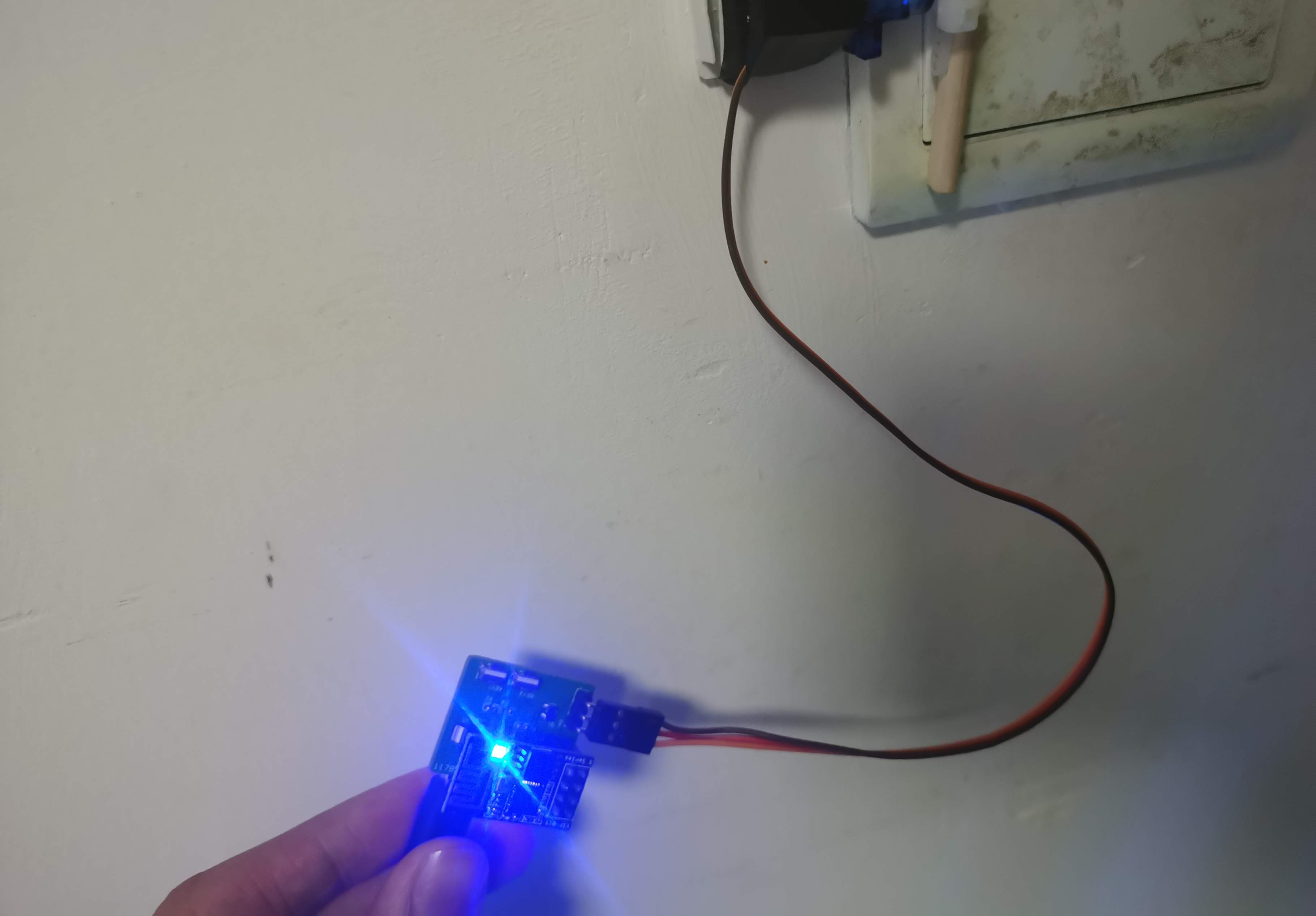

Ultra-small size esp-01s base plate control servo switch light
# esp-01s servo control base plate
demonstration: https://www.bilibili.com/video/BV1xK411B7d7
Program source code: https://github.com/ThinkCodeStudio/esp-01s_control_servo
esp-01s control servo base plate:
* Supported programs Download ## There are two buttons `BOT` and `RST` on the bottom board of
the download program . Press and hold `BOT`, then press `RST` and then release `RST` to enter the download mode. ## 0pin of the baseboard control logic esp-01s Connect to a mos tube to control the power supply of the servo. This is because the servo operation will produce noise. If the servo is continuously powered, the servo cannot change the angle and will affect the normal use of the switch. 2pin is the normal servo control pin. ## PCB BUG I don’t know why. If the servo is connected to the base plate and the esp module is restarted, the esp module will not run. The servo keeps rotating and the esp module cannot be started. The servo must be disconnected, power is supplied to the esp module first, and then the servo is connected. I can't solve this.
