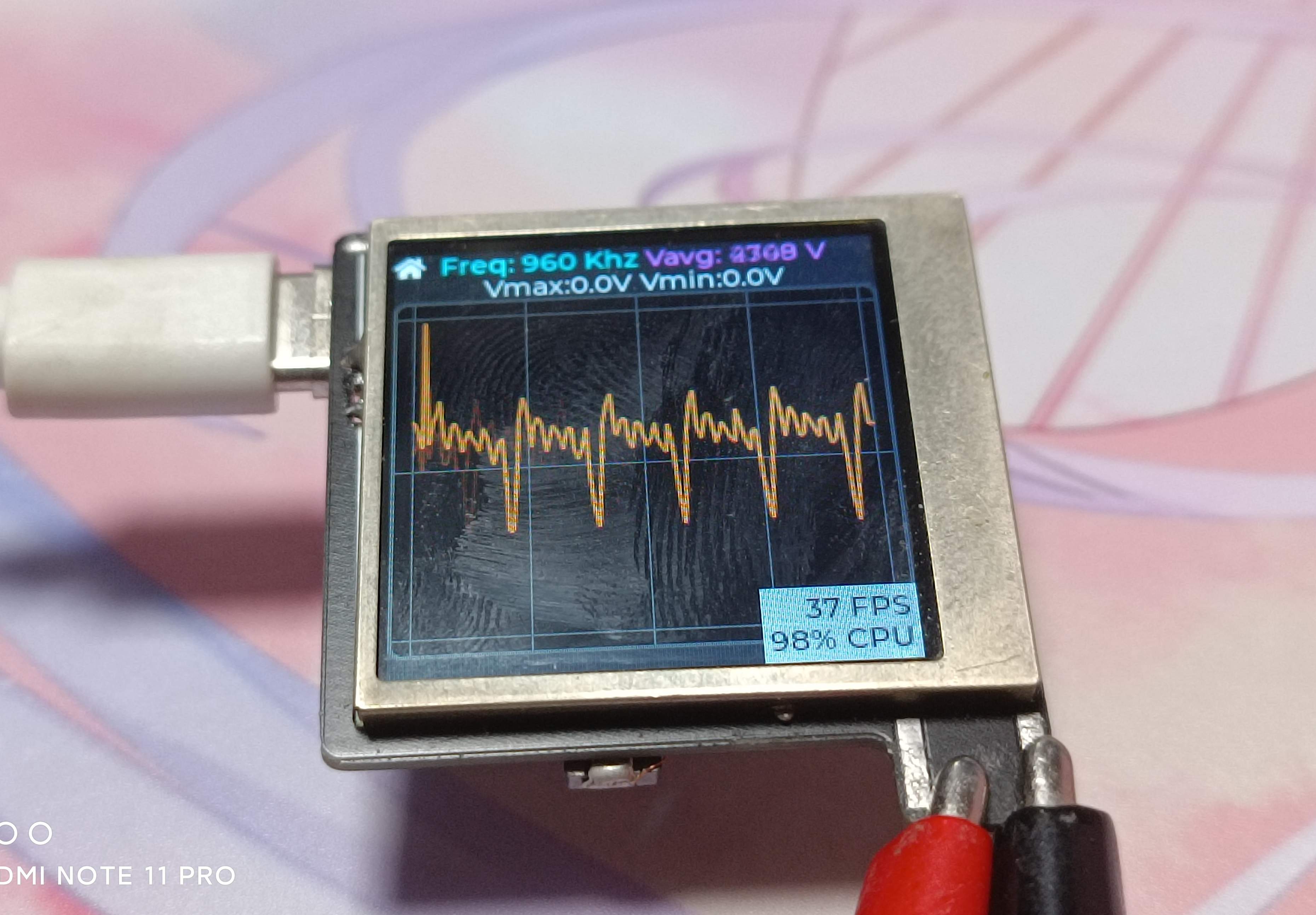

60M @ 12bit, 256pit depth mini oscilloscope
Upgrade tip: ADC can be replaced with AD9226 (65MSPS, supports replacement with AD9220 pin 2 pin)
The theoretical sampling rate can reach 70MSPS @ 280Mhz or 63MSPS @ 252Mhz
The main frequency depends on the highest frequency (constitution) of FALSH. It is recommended to use 133Mhz flash. After testing, W25Q128BF can run stably at the main frequency of 280Mhz.
Thanks to the group friends for providing AD9226 board test. The core voltage is 1.35V, the main frequency is 252Mhz, FFT is turned off, the actual sampling rate is about 60M (theoretical 63M)
Signal source 2Mhz duty50% PWM
It is easy to see from the figure: 256 sampling times are about 4.27us, a single sampling is 16.67ns, and the frequency is 59.98M
AD9220 solution, core voltage 1.2V, main frequency 280Mhz, FFT enabled, actual sampling rate is about 46M (theoretical 46.66M)
It is easy to see from the figure: 256 sampling times are about 5.53us, a single sampling is 21.6ns, and the frequency is 46.29M

The measured AD9220 can be overclocked to 25M+, and the ultimate performance is being tested
The MCU, ADC, and screen are all running overclocked. It is normal for the board to be a little hot.
ps: RP2040 can run up to 420Mhz, but the 1.3V chip I soldered is above 280Mhz, and the qspi frequency is divided to 8 and it cannot run. I suspect that the frequency dividing setting does not take effect.
ps1: Be careful to enable the fast Fourier transform in the source code to find the frequency. It is currently very unstable.

Main control MCU:
  • RP2040 with Raspberry Pi
  • Core voltage 1.2V
  • System frequency 280Mhz
  • After testing, it can run stably (without turning on FFT)
ADC:
  • AD9220
  • 12bit@25Mhz (40.2ns)
  • Input voltage range -3.3V-6.6V adjustable
  • Overclocked, a little hot
Screen:
  • 8-bit parallel port driver
  • Resolution 240x240
  • Due to lack of small money, I used the stock screen, model HL015Z1E
  • The binding chip is st7789, please find products/replacements by yourself.
  • Turn on the inverse color for the initialization parameters of the substitute, and the display effect will be better~
storage:
  • 128Mb SPI Flash
  • Used to store firmware
  • Can store waveform files
0x03:Software framework
Compile:
  • Compiler c sdk for raspberry pi
  • Develop using the PlatformIO extension for vs code
  • The PIO development package used is WizIO-PICO
In order to improve efficiency, the c sdk used for compilation has been modified. In theory, it can be compiled normally using the official SDK (now it has basically been replaced and can be compiled directly)
Display frame:
  • The display frame uses lvgl8.2
  • The screen driver mode is gpio batch operation
adc collection:
  • The collection depth is 256pit
  • Sampling accuracy 12bit
  • Accurately control sampling frequency using assembly
  • In the future, pio will be used with idle cores for sampling.
Automatic control:
  • Calculate the maximum value and variance of sampled data
  • Automatically control the ADC’s ​​reference voltage and sampling range
  • No need to worry about missing small waveforms
