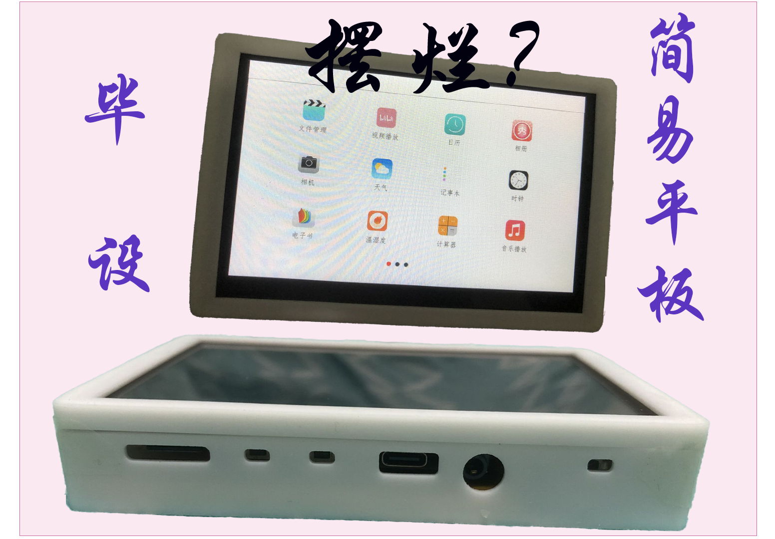

1. Main research contents
   This topic is the design and implementation of a simple tablet based on Linux and Qt5. The main research content is related to Linux and Qt5. By transplanting the Linux system, you can master Uboot compilation, Linux kernel trimming, file system mounting and other related operations. You are also familiar with driver mounting and uninstalling, device tree writing, etc. By writing Qt5 applications, you can understand C++ language programming, understand the operating mechanism of slots and signals, and be familiar with the calling relationship between each module. Understand the general process of product development through the design of the entire system from hardware to software.
    This system is divided into three parts: hardware part design, system part design, and application part design. The design of the hardware part includes starting from device selection, main control chip, screen, speaker, battery management, etc., to schematic drawing, PCB layout and wiring, Jialichuang board making, welding and a series of processes. System part design includes cross-compiler installation, Uboot transplantation, Linux kernel tailoring and compilation, file system tailoring and mounting, Tslib transplantation, Mplayer transplantation, Qt transplantation, driver transplantation, driver writing, script language writing, etc. The application part includes video playback, music playback, photo playback, checking date and time, checking weather, checking temperature and humidity, checking settings, reading e-books, using notepad, using calculator, playing NES games, etc. Through the design of these three parts, a device with tablet functions is completed.

4. Hardware design
1. Core board introduction
   The design size of the core board is 3cm * 5cm, and it is designed using a four-layer board. The purpose of the core board design is to facilitate expansion, mainly to build a minimum system based on the main control, which can be run on a single core board. The core board design hardware includes Allwinner's V3S main control chip, as well as some V3S peripheral circuits, crystal oscillator, reset, etc. It also uses a DCDC chip EA3036 to provide 3-way power supply to provide power to the V3S. The MINI PCIE interface is used to connect to the base board. MINI PCIE can lead out 56 pins. The FPC row of the RGB screen is led out on the core board. In this way, the RGB screen pins are removed, and basically all the remaining pins can be led out. The core board also has a W25N01GVZEIG memory chip onboard, which can be used to store the system, and then does not require an SD card to run and start.
2. Baseboard introduction
   底板设计大小为7.6cm * 10cm,采用两层板进行设计。底板设计的主要功能就是构造简易平板所需的功能,包括一键开关机电路,电池接口,RTL8723BS WIFI蓝牙模块,耳机,8002B功放芯片,DS3231时钟芯片,SHT30温湿度芯片,MPU6050陀螺仪芯片,震动马达接口,SD卡接口,音量加减键,关机键,复位键,还板载了RGB屏幕背光电路等。通过底板上这些器件的运行可以保证实现本系统所需要的功能。
