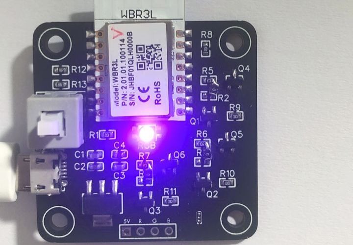

This is a large board based on RGB lights based on Lichuang EDA and Tuya . It is only used to control a small LED light. Smirking:)
In fact, it can be seen that this module controls 3 switch states. As for its ability It cannot be PWM, and you still need to receive the module test before you know:)
Update on December 3:
The board has been soldered. Although I selected low-level valid in the firmware configuration, the module sent is based on the default high-level valid. Burned firmware! ! !
If you design the PCB according to me, there is no way to use it ~
I can only fly 3 0R resistors to use the flying wires.
Also, let’s talk about dimming. I don’t know whether it is an RGB selection problem or a program problem, although it can also be adjusted. , but it cannot completely follow the lighting changes set by the APP.
It’s not my own program, it’s just not easy to mess around with!
