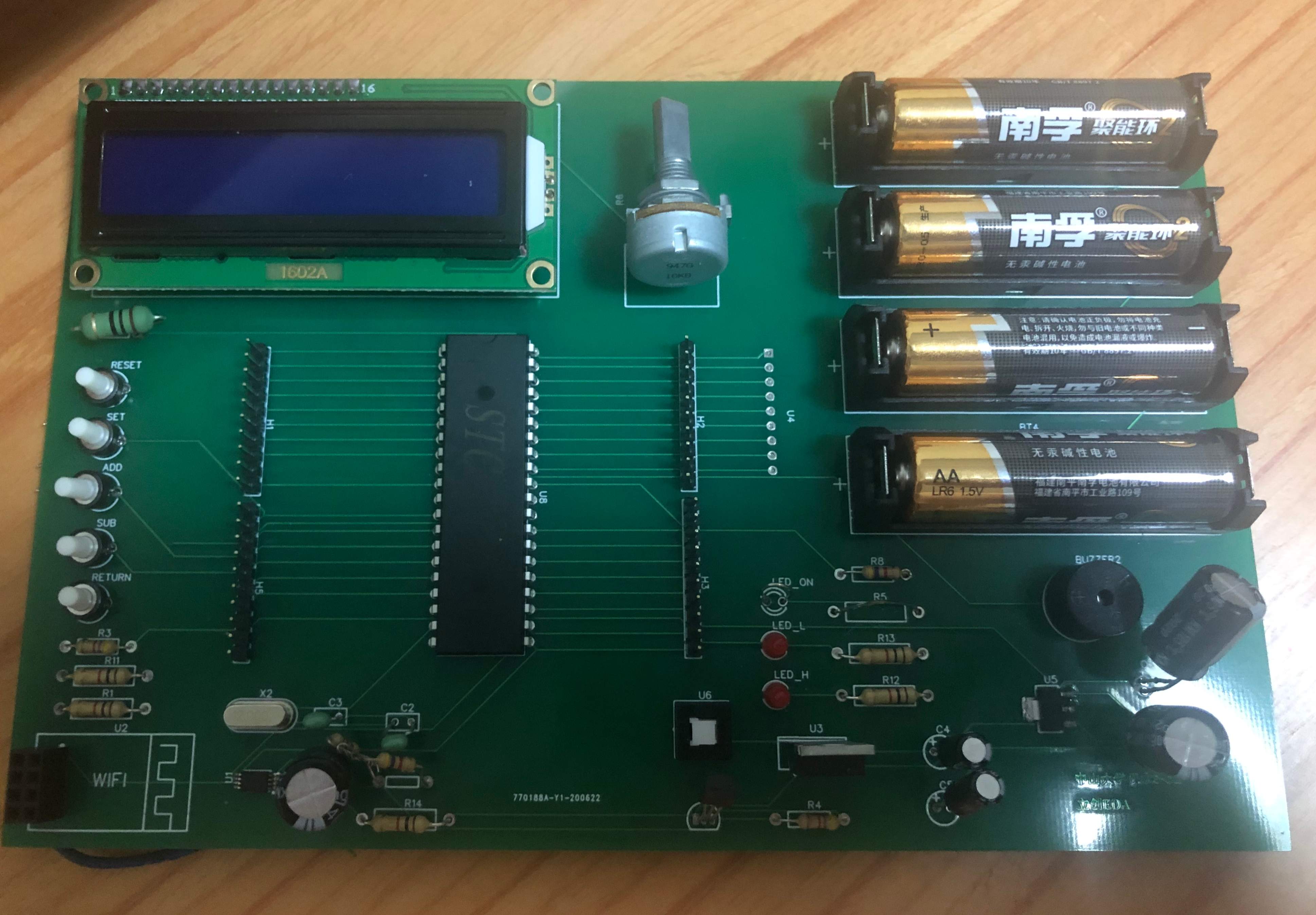

**5、******系统整体设计******** ****(此处的原理图及PCB设计使用的是立创EDA,所使用电子元件均在立创商城购买)******** ****整体系统:******** ![图片4.png] ****1.显示模块******** ![图片5.png]
第1脚:接地 第2脚:VDD接5V电源正极 第4脚:寄存器选择,高电平时选择数据寄存器、低电平时选择指令寄存器 第5脚:读写信号线,高电平时选择读操作、低电平时选择写操作 第6脚:enable端 第7-14脚:数据端 屏幕显示内容: ![图片6.png]
包括: TEMP:当前温度 SETH:设定上限温度 SETL:设定下限温度
****2.报警提示模块******** ![图片7.png] 由两个LED报警提示和一个蜂鸣器组成,温度超过设定最高温度时D2亮,蜂鸣器报警;温度低于设定最低温度时D1亮,蜂鸣器报警。 ****3.供电模块**** ![图片8.png] Use four 1.5V batteries and a 7805 three-terminal voltage stabilizing integrated circuit as the power module, add two grounding capacitors to filter the AC component, and the out is about 5V. ![Picture 9.png] Considering that the working voltage of the LCD display and WIFI module is 5V, and the working voltage of the microcontroller is 3.3V, a 3.3V voltage stabilizing chip is connected in series to the output terminal OUT of the original power module, which can stabilize the 5V voltage of the battery power supply. to 3.3V. When the line is connected, the 5V working voltage module uses the OUT terminal for power supply, and the 3.3V working voltage module uses the VOUT terminal for power supply. ****4.WIFI module**** ![Picture 10.png] The working voltage of the ESP-01S chip is 5V, so it is powered by the IN terminal of the power supply. Communicates serially with the microcontroller and sends data to the PC. ****5. Temperature acquisition module**** ![Picture 11.png]
****6. Button module** ** ![Picture 12.png] Key function description: SET: Press once SET: Set Upper limit temperature Press SET twice: Set the lower limit temperature ADD: Add one to the set temperature value SUP: Subtract one from the set temperature value RETURN: Return to the temperature display interface **6, ******Simulation test**** * ** ****Temperature display function test: **** ** (1) Turn on the system switch and set the ambient temperature to 25°C ! [Picture 13.png] (2) Observe the LCD screen for 1s Then it responds to the temperature change and displays 20°C ! [Picture 14.png]
**** Manual change function test of upper and lower temperature limits: ****** ** (1) Set the default upper and lower temperature limits to 30°C, 20°C ![Picture 15.png] (2) Use the buttons to modify it so that the upper and lower limits are 35°C and 15°C ![Picture 16.png] ****Dangerous temperature alarm function test: ****** ** (1) Over the upper limit ! [Picture 17.png] Experimental results: ! [Picture 18.png] The high temperature alarm LED turns on and emits light, the buzzer P10 port forms a high potential, and the buzzer alarms (2) Beyond the lower limit ! [Picture 19.png] Experimental results: ! [Picture 20.png] The low temperature alarm LED is turned on and emits light, the buzzer P10 port forms a high potential, and the buzzer alarms. Simulation test results: The function is in line with expectations. **7. ******Physical test adjustment****** ** (1) The working voltage of each device is not uniform, and the same current source cannot be used. Solution: Add two voltage stabilizing chips l 7805 voltage stabilizing chip to stabilize the battery power supply voltage to 5V l SSP-1117 voltage stabilizing chip to stabilize the 5V voltage to 3.3V Different devices will use different power supply ports (5V / 3.3V) , each module has achieved normal operation . At the same time, in the voltage stabilizing chip module, we also configured a grounding capacitor to derive the AC component to make the system work more stable. (2) Abnormal LCD display. After voltage probe testing, it was found that the voltage of the LCD module was too high. Solution: Adjust the LCD module pull-up resistor. After adjustment, the LCD displays normally. (3) Circuit welding: Due to weak soldering of the circuit, the system could not work normally, and it was found after investigation. During the physical welding process, attention should be paid to checking for virtual soldering and pin short circuits caused by errors during the welding process. Especially when welding microcontrollers and integrated chips, due to their small pins and dense arrangement, they need to be operated very carefully and checked in time. (4) Microcontroller switching circuit. It was originally considered to place an LED light display in the switching circuit of the microcontroller and connect a resistor in series to divide the voltage to prevent the voltage at both ends of the LED from being too high and burning out the LED. However, after welding, it was found that the output voltage was lower than the operating voltage of the microcontroller due to the voltage reduction of the LED. After consideration, the LED and resistor of the switch circuit were deleted and replaced with wire connections. (5) Buzzer voltage adjustment During the test, it was found that the output voltage of the buzzer corresponding to the microcontroller pin was too low, resulting in an inconspicuous sound of the buzzer. After considering several solutions, the buzzer was adjusted. The way of voltage is so that the voltage of the buzzer will not be too low when the output voltage of the corresponding pin of the microcontroller is low level, and at the same time, the buzzer will respond normally when the pin outputs high level. The following is the component list: (The components used are all products from Lichuang Mall) ![Picture 21.png] **8. ******Summary and Reflection****** ** In this electronic In the design practice, we completed the design of a temperature monitoring system based on a single-chip microcomputer. We have a deeper understanding of the structure and functions of microcontrollers, learned and experienced the process of system experiments, and felt the infinite charm of electronic information technology. The portable temperature monitoring system we designed and implemented has a simple structure, is easy to transplant, and has certain practical value. At the same time, there are still many areas for improvement in this system, such as the maximum measured temperature of 99°C and the large remote monitoring distance limit. In future study and practice, we will continue to improve our own quality and improve product performance so that it can be better used in people's production and life.
