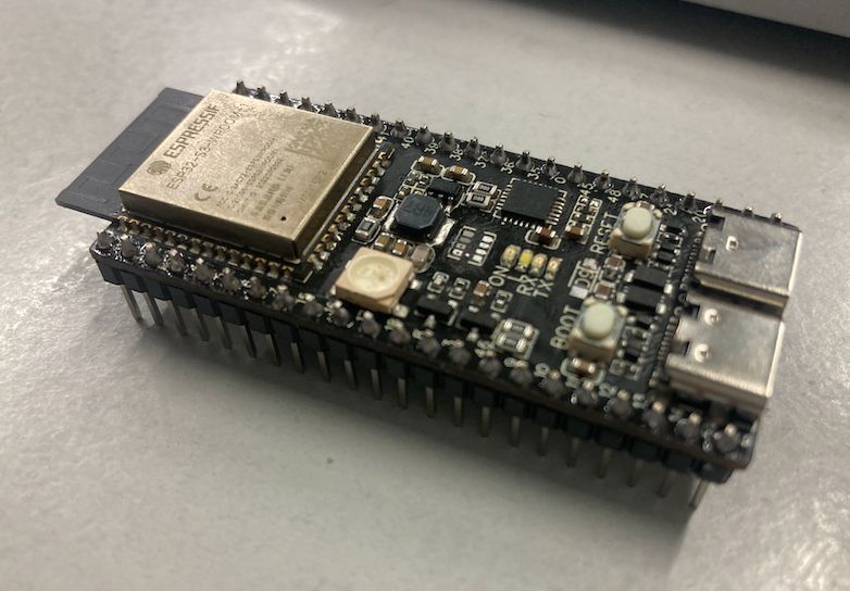

ESP32S3-WROOM-2TypeC
  -This project is developed and improved based on ESP32S3-DevKitC-1, upgrading the power supply and on-chip peripherals
  - It has a power indicator light and a Uart (RX/TX) indicator light
  - It uses the SY8088 chip as a DC step-down to power the 3V3 network, which is effective Increased system power supply capability
  - Used larger package WS2812 to make RGB cooler
  - Adopted a compact dual C-port design, making the whole board compact and exquisite
  - Stacked protection circuit design, each C port has an independent Isolated by diodes, D+/D- and VBUS have independent overvoltage protection, and the entire Vin network has TVS protection
