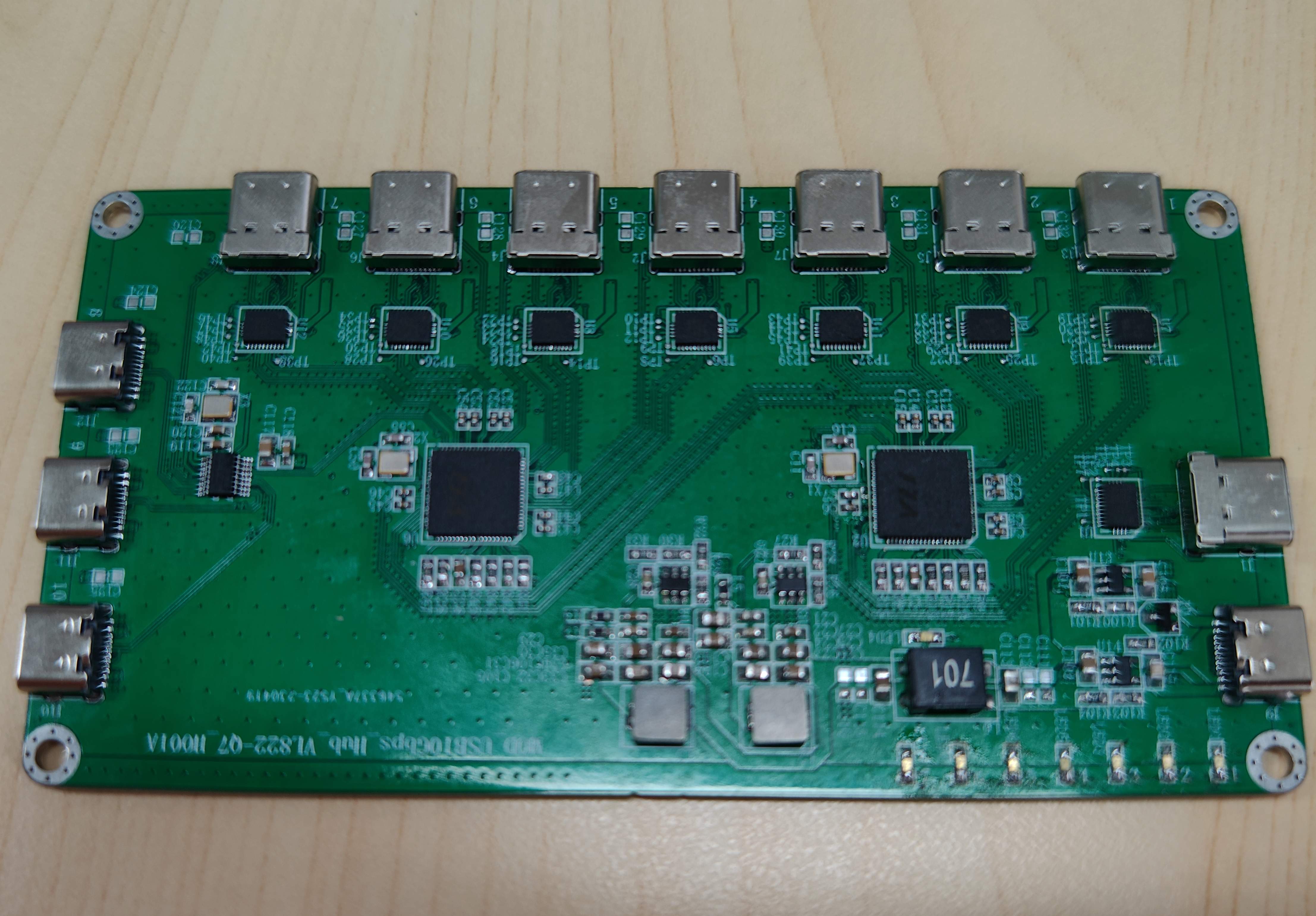

10-port full Type-C hub based on VL822-Q7
The 10-port full Type-C hub based on VL822-Q7 is handmade (it broke my waist), and the actual speed is a bit miserable, so it is for reference only.
The main control uses two VL822-Q7 and one SL2.1S cascade, expanding 7 10Gbps ports and 3 480Mbps ports; Type-C uses 8 VL160 to implement MUX, with 1 uplink and 7 downlinks. (Attached is the original AD project file)
