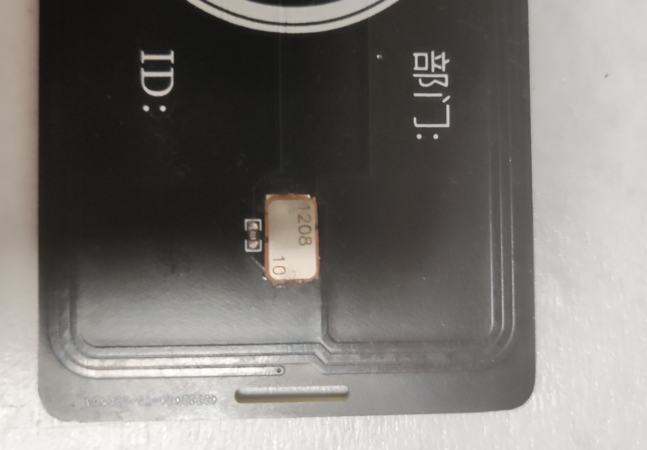

Standard business card size, standard coil drawing method. The chip is universal, with LEDs on the front and back. The board has been verified. Chips have been tested: S50, C50, UID, CUID, FUID, 1208-9, 1208-10, etc. I personally recommend the 1208-9 (pure CPU) solution.
The welding effect of using 3*5 package is as follows:
the welding effect of using 5*8 package is as follows.
It is recommended to use a soldering station and add a large amount of flux.
When soldering the 5*8 chip connector with a soldering iron, be sure to clean the soldering iron tip.
