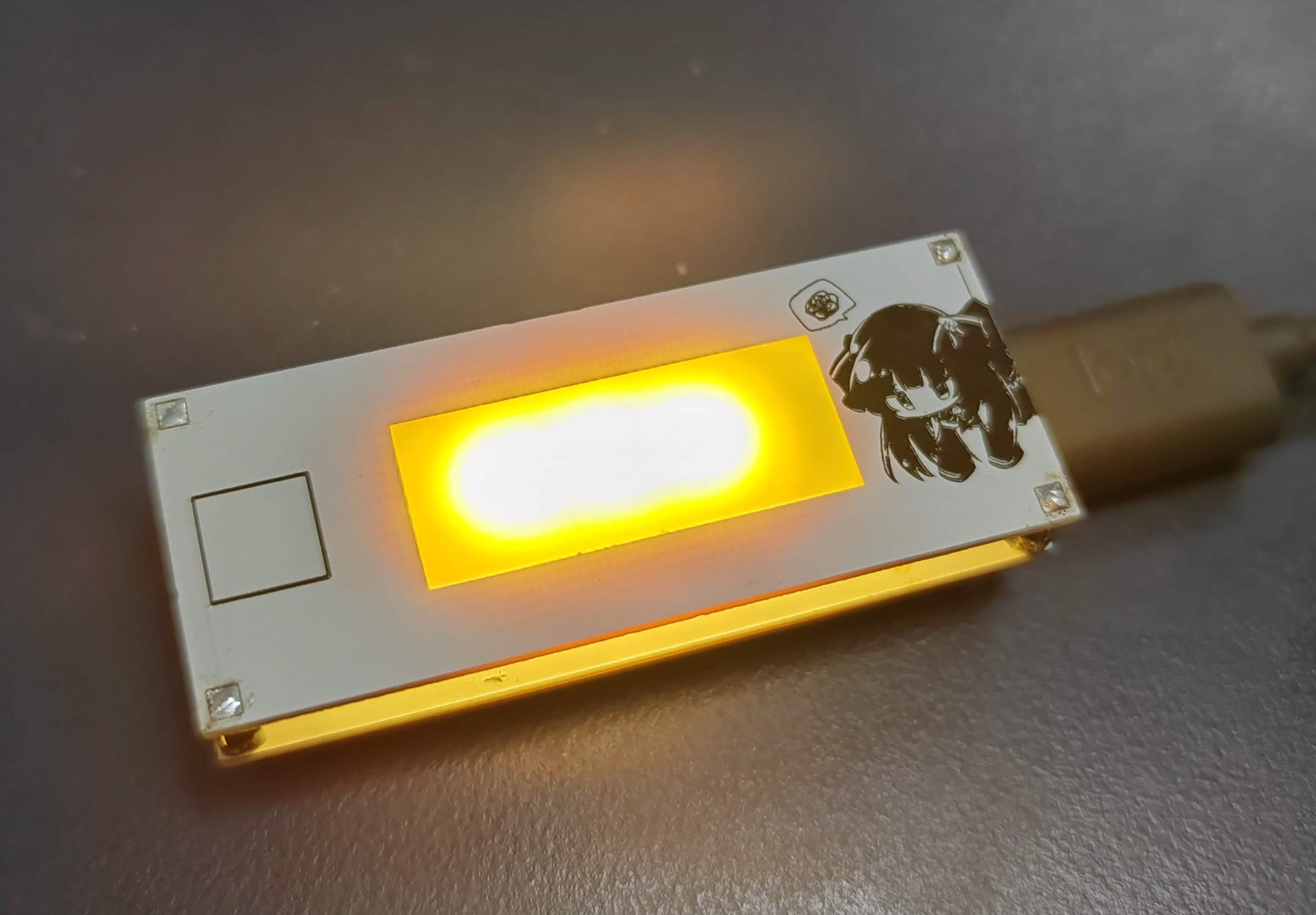

12V touch dimmer light
The key schematic is taken from the touch dimming light bulb (based on 8022W solution + 26mm LED filament) - Jialichuang EDA open source hardware platform (oshwhub.com)
The 5V to 12V design is taken from the three-terminal MT3608 boost circuit - Jialichuang EDA open source hardware platform (oshwhub.com)
The reason for doing this is that when I was cleaning up the laboratory, I found a few such lamps
and tested them by hand. I clicked on it, 12V, very bright. It happened that my junior student said that he was short of a desk lamp, so he made a driver board based on the shape of the lamp.
So don’t ask why the lights are not integrated on the board, because the vinegar is made first and the dumplings are made later.
After the completion of the lamp, the main board and the light-diffusion plate are connected through pin header welding. The light pass-through
can work normally without the need for a light-diffusion plate.
It will turn yellow after passing through the uniform light board.
All those who have used it said it is good. qwq
Thanks for the board from Lichuang Duofa. However, the materials are limited (the lamp is used up). I only made three ww
precautions:
When making the uniform light board, try to choose it as thin as possible. The effect in the picture above. The choice of resistor and capacitor with a thickness of 1.0mm is
based on the silk screen. The current limiting resistor is about 200 ohms and the brightness is suitable.
